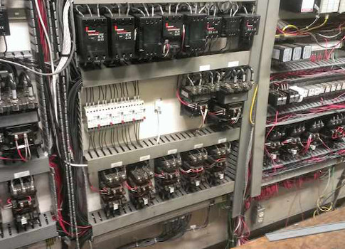

One of those e-houses is a 20-foot-long trailer mounted up a flight of stairs on a mezzanine. It is filled with breakers, PLC panels and had a an arc flash hazard rating of Category 3, which corresponds to an incident energy of 8 to 25 cal/cm2. The Category 3 rating requires anyone working inside it to wear personal protective equipment (PPE) consisting of safety glasses or goggles, hearing protection, hard hat, cotton underwear, fire-resistant (FR) shirt and pants, FR coveralls (in addition to FR shirt and pants), arc flash hood, leather gloves and leather shoes.
