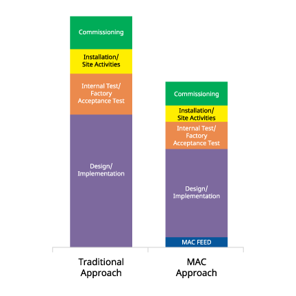

Compared to a traditional project management approach, the MAC concept enables drastic cost savings to the overall project. Many end users, particularly in the process industries, have applied the MAC approach to entire capital projects. That can result in project cost savings of up to 30% compared to a traditional approach.
Since automation suppliers are encouraged to consolidate industry and application expertise to execute projects in a consistent manner, costs are reduced in almost all phases of the project. This has led to the development of standardized practices and procedures, which can be applied across multiple projects to reduce costs. In addition, MAC suppliers often have introduced innovative project management practices such as decoupling hardware and applications software, removing dependencies to allow multiple aspects of projects to be executed in parallel, reducing the number of project gates and simplifying the commissioning process.
Figure 1: The MAC approach can reduce project costs by up to 30%.
Figure 1: The MAC approach can reduce project costs by up to 30%. Courtesy: Yokogawa

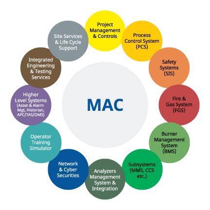

While typical MAC services could comprise all aspects of the automation scope, MAC suppliers have expanded their services in many directions. For example, in recent projects, the extended services, often referred to collectively as “MAC+,” have included the supply of instrumentation, process equipment such as pumps and valves, communications services and IT services. By consolidating additional services, MAC+ providers offer end-users even further savings.
Figure 2: Example of a typical automation project MAC scope. Courtesy: Yokogawa
