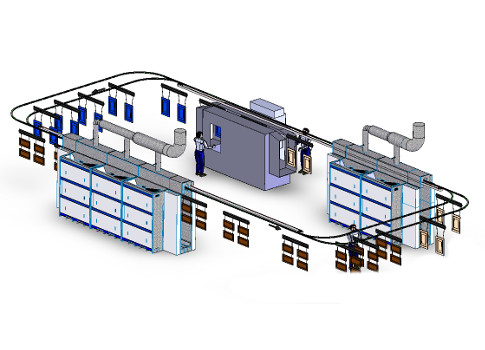

Curing systems using gas-fired catalytic infrared panels are gaining in popularity for parts or all of the process. Theseanels can be placed along the conveyor line, either in an open configuration or in an enclosed tunnel. Infrared curing is faster than convection ovens and can be closely adjusted to the size and shapes of the target objects being coated. In some cases, infrared is used to gel the paint on the objects before they enter a conventional convection oven. This shortens the bake time, allowing more production throughput.
Although powder coating was initially used only on metallic objects, techniques have been perfected for powder coating other materials, including plastic, wood, and especially medium density fiberboard (MDF). The MDF opportunity is important because this material is widely used in furniture, cabinets, recreational items, paneling, containers and shelving. The key to successfully powder coating MDF is to preheat the material, which increases its electrical conductivity, allowing it to be effectively grounded to cause the powder to adhere. Here again, the use of catalytic infrared panels makes this process effective.

One of the major providers of catalytic infrared heating systems is Heraeus-Vulcan. This company offers natural gas-fired systems specifically designed for the powder coating industry. According to company spokesman Mike Chapman, infrared systems offer design flexibility, allowing a thermal treatment area to be adapted for various coatings and product types. Chapman also notes the short cure times for infrared versus convection oven systems. Infrared systems can also be created to allow for product pretreatment before a convection oven, and controlled cooling at the other end of the process.
Chapman stresses that powder coatings for MDF products is an important trend. He explains, “The first part of the process is to heat the MDF to around 50° C (122° F) to draw moisture to the surface. This makes it conductive. So it is very important to use MDF that has a moisture content between 5% and 8%. The other issue with powder coating MDF is the need for quality. It needs to be dense with a strong internal bond so it can withstand the rapid heating and cooling that it will undergo in the powder coating process. Poor quality MDF will split and crack on the edges where there are cut surfaces when it is powder coated.”
