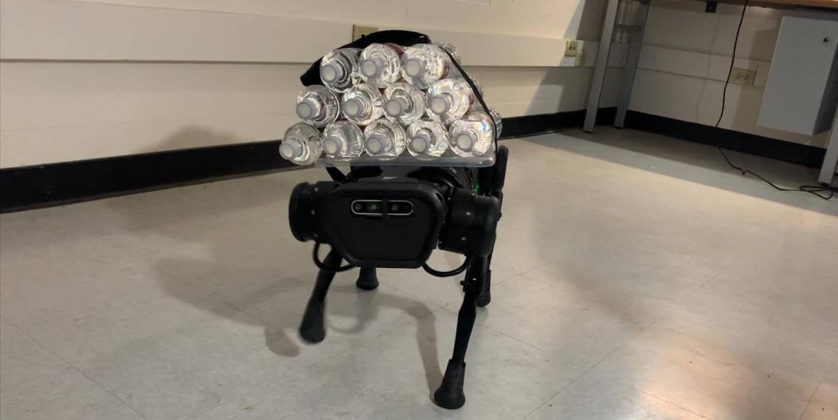

A quadruped robot from USC Viterbi assistant professor Quan Nguyen's lab carries half its body weight in water bottles. Courtesy: Mohsen Sombolestan, USC Viterbi
A quadruped robot from USC Viterbi assistant professor Quan Nguyen’s lab carries half its body weight in water bottles. Courtesy: Mohsen Sombolestan, USC Viterbi

“Even having a robot stand with a heavy weight on its back is a big challenge — and a big accomplishment,” Nguyen said.
To truly advance the robot’s locomotion, the researchers looked further. Instead of just settling for a robot that could stand up with a heavy weight on its back, they designed an algorithm that allows the robot to move around rough, uneven or even sloped terrain while carrying weight. The robot adjusts to its environment continuously, like an actual four-legged animal might.
The research team has developed advanced algorithms based on adaptive control to offer the following advantages: robustness to uneven surfaces, ability to manage friction within certain constraints and softening of impacts on the robot’s locomotion. The novel framework was validated in both computer-based simulations and in live hardware experiments. In both cases, a 26-lb. robot was used along with a 13-lb. load (water bottles that made up 50% of the robot’s weight). Standing on four legs, the robot was able to carry up to 92% of its weight—24 lbs. on its back.
