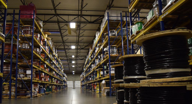

Figure 1: Electricity poses a unique safety risk given it is used to power virtually everything on the plant floor. Courtesy: Wesco

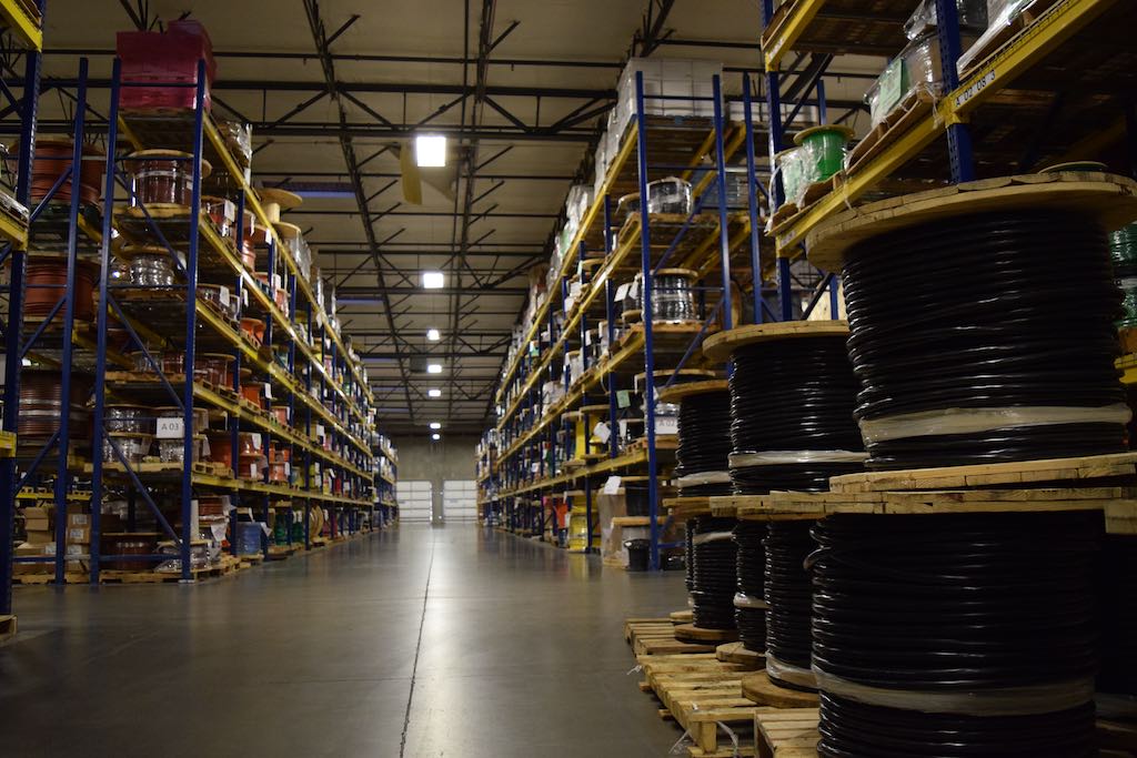

Figure 2: Electrical hazards can hide in plain sight. Implement a “find and fix” approach and let the employees be the eyes and ears of the manufacturing facility. Courtesy: Wesco

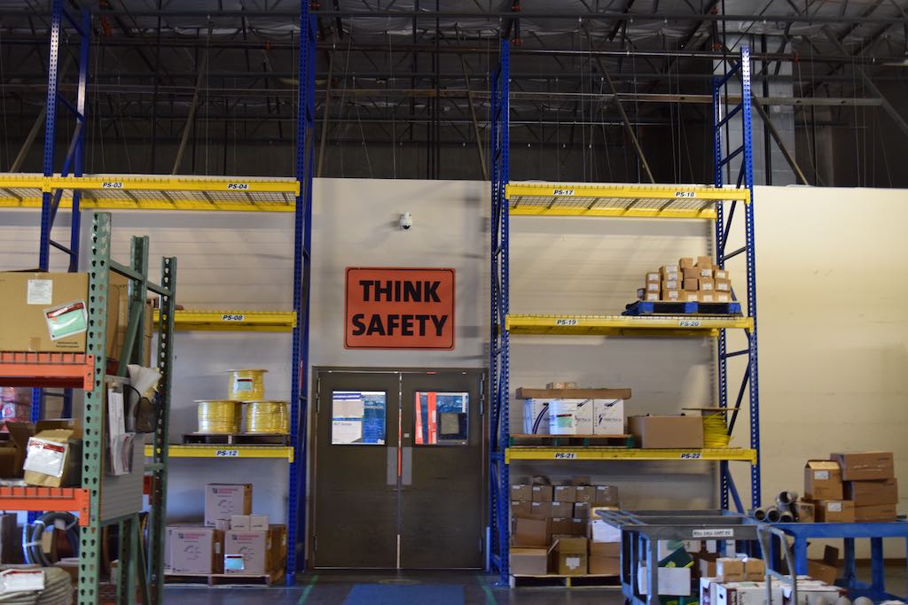

Figure 3: Ensure equipment is not stored in hazardous environments or in an area where employees frequent along the plant floor. Courtesy: Wesco
