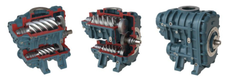

Rotary screw compressors are largely versatile units (see Figure 1). George Lutzow, manager, SKF application engineering experts for SKF USA Inc., said, “Most common screw compressor designs have two rotors counter rotating with bearings at each end.”
Figure 1. Two-stage rotary screw compressor, SKY2.
Figure 1. Two-stage rotary screw compressor, SKY2. Courtesy: Kaishan Compressor.

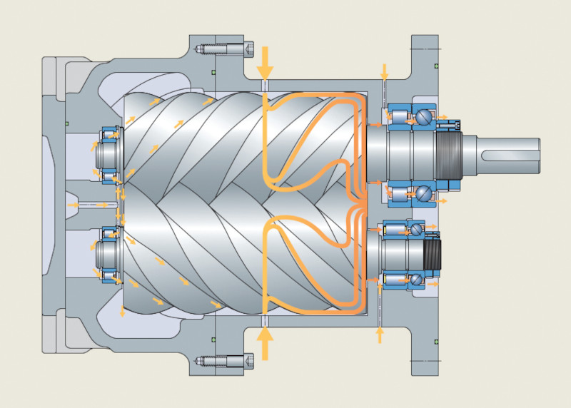

There are oil-free and oil-injected designs available to accommodate numerous uses and applications. Oil-injected rotary screw compressors operate with oil injection that seals clearance between the rotors and the cylinders. The oil is necessary to perform several crucial functions, such as cooling, sealing, lubrication and noise reduction. “The oil that lubricates the bearings also is injected into the compression process for cooling, rotor lubrication and to improve efficiency by creating a dynamic seal between the rotors and the compressor housing,” said Lutzow. (see Figure 2).
Figure 2. Typical oil injected compressor cross section.
Figure 2. Typical oil injected compressor cross section. Courtesy: SKF USA, Inc.
He continued, “The oil is critical to separating the rolling and sliding contacts within the bearing. The lubricant also provides corrosion protection and cooling to the bearings.” Although oil-free rotary screw compressors still use lubricants, these lubricants are typically formulated to last the lifetime of the compressor.”

Different compressor types have different bearing designs (see example in Figure 3). Typical bearings used in rotary screw compressors are roller, sleeve, ball and journal bearings. The rolling bearings in screw compressors provide precise positioning of the rotors and support rotor loads.
Figure 3. SKY airend – rotary screw airend with four bearing arrangement on discharge: roller, angular contact and ball.
Figure 3. SKY airend – rotary screw airend with four bearing arrangement on discharge: roller, angular contact and ball. Courtesy: Kaishan Compressor.

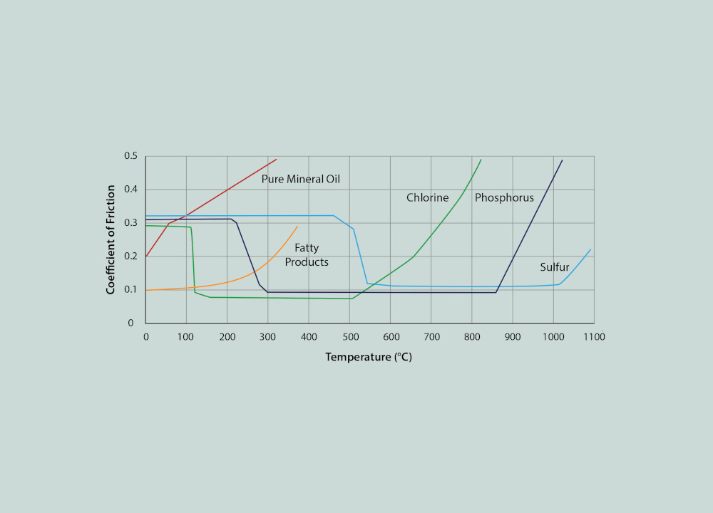

For bearing wear protection, AW and EP additives are utilized. Regarding their differences and typical uses, Hunter explained, “There is no clear distinction regarding the use of the terms anti-wear and extreme pressure. Both additive types form a large group of chemical additives that protect metal surfaces during boundary lubrication by forming a protective film or barrier that reduces wear of contacting surfaces.”
Hunter continued, “However, one can loosely distinguish between the two types based upon operating speed and load (pressure and temperature). Additives that perform best under milder conditions, typically higher speeds and lower loads, are referred to as AW additives, and those that perform best under more severe conditions, typically lower speeds and high loads (resulting in high temperatures), are EP additives.”
AW additives protect against wear and the loss of metal surfaces, and the EP additives decrease wear due to high localized pressure, preventing seizures. As stated previously, they perform similar functions. Hunter explains, “Both AW and EP additives prevent metal-to-metal contact by forming a film that yields under the shear stress imposed during boundary lubrication conditions. It is the heat from the friction generated between moving surfaces that provides the energy for chemical reaction between the additive and the metal surface to form sacrificial, protective films. These films fill the asperities, thereby reducing friction by preventing metal-to-metal contact, which can prevent surface wear and welding. However, the films are labile at high temperatures and are removed by the moving surfaces in contact. New films must form on the nascent metal for continued protection.” Figure 4 shows the temperatures at which different AW and EP chemistries react to form protective films.
Figure 4. Effective temperature ranges of AW and EP additive chemistries.

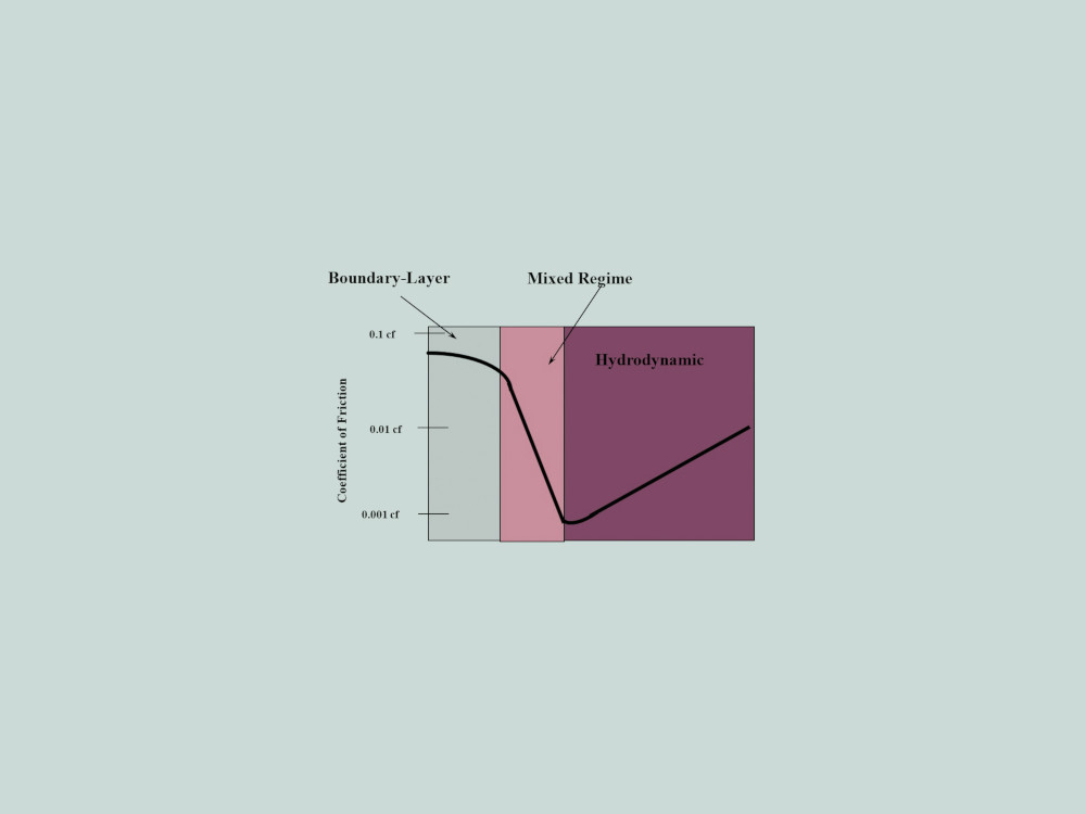

A specific operational challenge within rotary screw compressor operation can be fluid flow to bearings at compressor startup — and specifically startup at colder ambient temperatures in which boundary or mixed lubrication regimes can occur. Hunter explained, “Boundary lubrication is generally an undesirable condition because there is increased friction and wear, energy losses and material damage. Machinery can experience boundary lubrication during startup and shutdown, even if it normally runs under hydrodynamic conditions.
“Under harsh operating conditions of high loads, low speeds and low lubricant viscosity, the lubricant film thickness might decrease to boundary lubrication conditions. This is because the film thickness and surface roughness are about the same dimension. When this occurs, AW and EP additives are needed to protect the surfaces.” The Stribeck curve is used to understand the different boundary lubrication regimes; it also measures efficacy of product friction. The product that demonstrates the lowest coefficient of friction is likely the best choice. 3 (see Figure 5). Hunter explained, “If the hydrodynamic oil film is maintained between the metal surfaces, boundary lubrication, where the two surfaces are mostly in contact with each other, will not occur, and AW and EP additives are not required to perform their function.”
Figure 5. The Stribeck curve demonstrates lubrication regimes; the optimal product is the one with the lowest coefficient of friction through various regimes.
Lutzow explained, “When the operating conditions result in a thin oil film, there is an elevated risk of damage for bearings. Lubricant additives are an option when these conditions occur. However more often the rotor speed, lubricant viscosity and oil flow characteristics of screw compressors generate suitable oil films to separate these surfaces and, as a result, it’s less common for compressor oils to be selected with an additive package. One industry trend that started almost 10 years ago is the practice of slowing the compressor speed as a method of controlling flow. This practice has been managed within the existing bearing solution. However, as environmental regulations are adjusted, greater compressor speed reductions might be required, which would result in greater risk to the oil film thickness. All these factors are considered, and when doing bearing life modeling and calculations, our primary focus is a balance of the bearing required viscosity versus the operating viscosity of the oil at operating temperature.”
