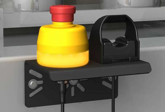

In an emergency situation, it is crucial that operators and others in the vicinity are able to stop hazardous machine motion or the process as quickly as possible. The swiftness relies on the E-Stop actuator being clearly identified, clearly visible, and readily accessible. The requirement for an E-Stop pushbutton to be red on a yellow background has gone a long way in improving “clearly identified” and “clearly visible.” Recently, identification and visibility have been brought to a new level with LED illumination.
New E-stop button technology combines the practicality of status indication with the safety inherent in emergency stop buttons in one, unique device. Two styles are on the market today: one with illumination in the pushbutton face and another with illumination in the enclosure base. The advantage of the illuminated base is generally more visibility via brighter indication and a 360-degree viewable surface.
Additionally, some illuminated E-stop buttons provide real-time status for workers on the plant floor. This can provide a solution to a common problem with E-Stop pushbuttons—identifying which button was pushed.
Illumination logic, whether provided externally or internally, allows workers to identify at a glance whether a button is armed or has been pushed. A pushed button can simply light up “red” or, in the case of an E-Stop with illuminated base, can indicate whether the button has been pushed (e.g., flashing red), the machine is stopped (e.g., solid red), or if the pushbutton is armed and the machine is ready to operate (e.g., yellow or green indication). Once the emergency situation has been rectified, users can easily identify and reset the button or buttons efficiently with minimal downtime.
Diverse environments
To address “readily accessible” concerns and accommodate various applications, E-stop buttons are offered in enclosures for mounting remotely from the operator control panel in nearly any location or directly on a machine. With no assembly and quick-disconnect connectors, E-stop pushbuttons can be installed simply, quickly, and cost-effectively.
