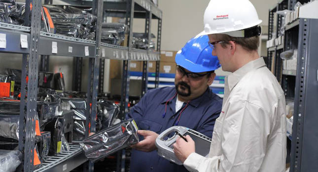

To address this situation, manufacturers must first understand what automation assets are installed in the plant and what exists in the storeroom to support those assets. This initial assessment will be the foundational piece that will serve as the basis from which data-driven strategies are derived and developed enterprise-wide.
Figure 1: Understanding and evaluating a company’s installed base, including supporting inventoried assets, is key to mitigating risk when operating obsolete systems. Courtesy: Rockwell Automation

  • Physical data collection – A field engineer manually collects the data. The amount of data collected depends on the size of the plant and requires some scoping. This process also includes collecting information on spare parts from the storeroom, which are essential for supporting the existing installed base.
  • Digital data collection – This approach involves running a data acquisition program across the network to identify and gather the data from the connected assets. In this scenario, the scope can be delivered on a turnkey basis as the size of the plant doesn’t impact it. The storeroom spare parts information is manually collected.
