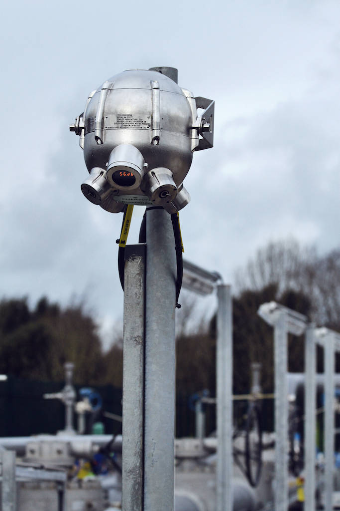

First, a gas leak can be detected acoustically via a listening device tuned to ultrasonic frequencies (Figure 1). Using an array of directional ultrasonic sensors, it is possible to get an indication of the general direction of the source, but an operator must pinpoint the location. This detects a leak rather than a specific gas, so it can’t determine which gas is present. For example, it can’t differentiate between compressed air and hydrogen sulfide, so operators must make the determination based on what might be present in the location.
Figure 1: An acoustic gas leak sensor, such as Emerson’s Incus™ Ultrasonic Gas Leak Detector, can hear the ultrasonic noise made by a leak and indicate the general direction of the source. Courtesy: Emerson

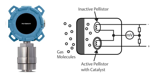

Second, combustible hydrocarbon gases and vapors can be detected through a chemical reaction with a catalyst (Figure 2). When the gas encounters the catalyst, it reacts with atmospheric oxygen, effectively combusting without actual fire. The action creates heat detectable via a temperature sensor. This approach is only suitable for point detectors and tends to respond comparatively slowly due to thermal inertia, although the speed of detection is sufficiently quick in most applications.
Figure 2: Emerson’s Net Safety Millennium™ Combustible Gas Detector uses two pellistors, one with catalyst and one without. Presence of a hydrocarbon gas or vapor causes the active pellistor to become warmer, which can be measured. Courtesy: Emerson

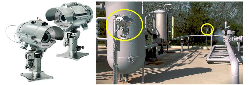

Third, various gases absorb specific wavelengths of light in the ultraviolet (UV) or infrared (IR) bands, which can be measured using differential optical absorption spectroscopy. A differential optical absorption spectroscopy detector monitors those wavelengths, and when they decline more than the overall light level, presence of the subject gas is the likely cause. The degree of attenuation can provide an accurate quantitative value of gas concentration on a near real-time basis. This is the most versatile approach since the technology can be configured in a variety of ways, and it responds very quickly.
Focusing on differential optical absorption spectroscopy

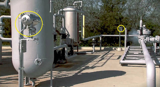

The primary advantage of differential optical absorption spectroscopy is its scalability. Two elements are required: a calibrated light source tuned to emit a specific wavelength, and a receiver able to read the same wavelength. In some cases, the receiver must also read a reference source for comparison. The two elements can be within the same housing to function as a point detector, but the source and receiver can also be separated, sending a beam across an open path, looking for a cloud of the target gas to move into its field of view.
Since the detector responds to a change in the intensity of specific wavelengths, there must also be a consistent light source for comparison. If both the target and baseline wavelengths are similarly affected, say by rain or a complete beam obstruction, the sensor will typically not cause a false alarm.
The two units (Figure 3) look from one to the other across the area of coverage. Both use lenses and shading to minimize any effects from ambient light since these systems must operate equally well in full sunlight and night-time darkness. Transparent covers protecting the equipment are often heated to minimize condensation or ice formation, each of which can interfere with transmission.
Figure 3: Emerson’s Rosemount™ 935 Open Path Combustible Gas Detector looks for attenuation of specific wavelengths caused by presence of a target gas. A gas cloud between the source and receiver triggers a response. Courtesy: Emerson
The specific wavelength selected must match the target gas, so it is necessary to select from a vendor’s offering. No single unit can handle every imaginable possibility, but then no facility has the potential to emit every imaginable kind of gas either. Hydrogen sulfide is detected using UV, whereas hydrocarbon gases affect IR. In situations where multiple gases are possible, it may be necessary to deploy multiple units. Fortunately, hydrocarbon gases have similar characteristics, so the same unit selected for methane can also detect propane and ethylene, although there may be slight differences in sensitivity.

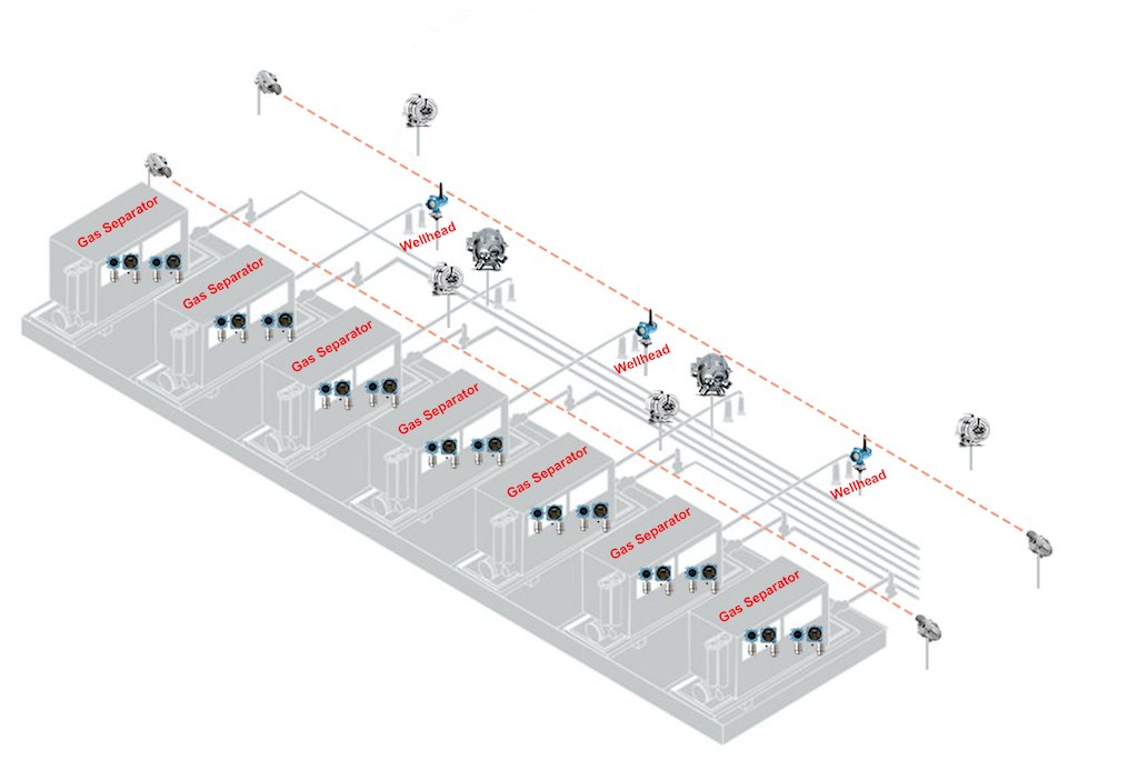

Open-path detectors have great versatility, but they should be deployed in conjunction with point detectors and acoustic detectors (Figure 4) to improve overall coverage. There are situations where gases may accumulate but open path detectors are impractical or too costly.
Figure 4: This wellhead illustration shows how all types of gas and flame detectors work together to create a truly comprehensive safety and emission control strategy. Courtesy: Emerson
But the larger safety discussion should not stop there. A fully integrated strategy for worker, plant, and community safety must include detectors for hydrogen sulfide, combustible gases, and even perhaps flame detectors. Designing such systems to be effective and economical will usually require a mix of the point and open path detectors just described. While it is difficult to rank these in importance, it could be argued that open path detectors carry the heaviest load of protection, and therefore deserve particularly careful consideration.
As a result, safety system design often begins with selection and placement of open path detectors, which are then supplemented by point detectors for areas of specific concern. When protecting workers from exposure to combustible gases and hydrogen sulfide, this is the best place to start.

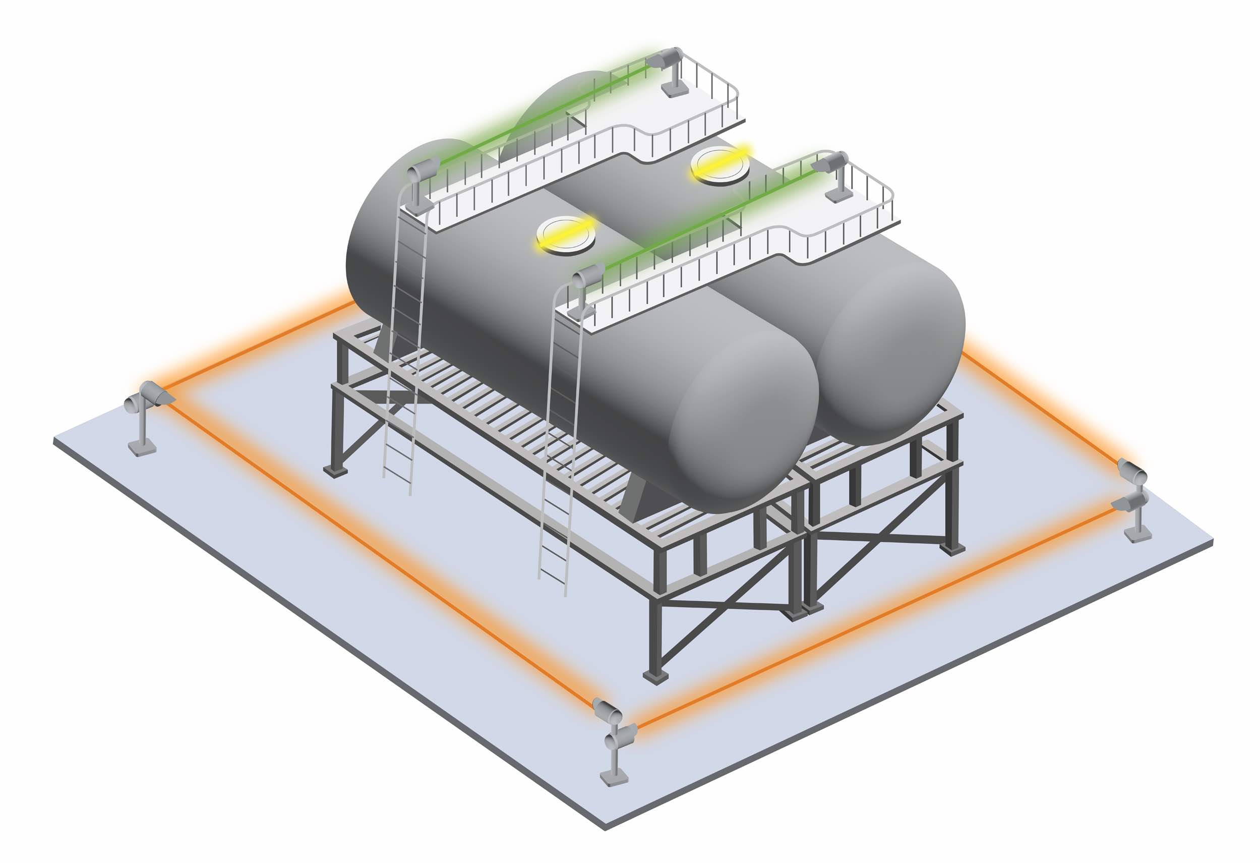

Sidebar: Open path sensor placement
This diagram illustrates typical open path sensor placement practices, following several basic concepts:
  • Open path technology can measure a gas cloud anywhere along its sight line between the transmitter and receiver set.
  • The total concentration measured is the product of the cloud density multiplied by the cloud size. So, a large low-density cloud can have the same effect as a small high-density cloud.
  • Beam location relative to specific equipment reflects a balance of sufficient diffusion to reach the beam, while retaining high enough concentration to be detectable.
  • Installation areas must remain clear of obstructions, such as parked cars, bins, and so forth, as blocking the beam renders the system inoperative.
  • Gas clouds tend to drift in the direction of prevailing wind, although direction can change.
This diagram illustrates typical open path sensor placement practices. Courtesy: Emerson
Looking at the diagram, there are four detector sets at the “fence line” around the equipment cluster, providing coverage for detection in all directions. These instruments should detect any significant release within the larger space. We’re assuming here that we are only concerned with one type of gas, for example hydrocarbons, which can be detected by the same type of detectors. If hydrogen sulfide is also a factor, for example, a second set of detectors is necessary.
Although not applicable in this case, it is important to avoid situations where beams are too close, causing the spreading beam from one transmitter to hit a different receiver. As a practical matter, this is easy to avoid with a bit of analysis based on angle data.
