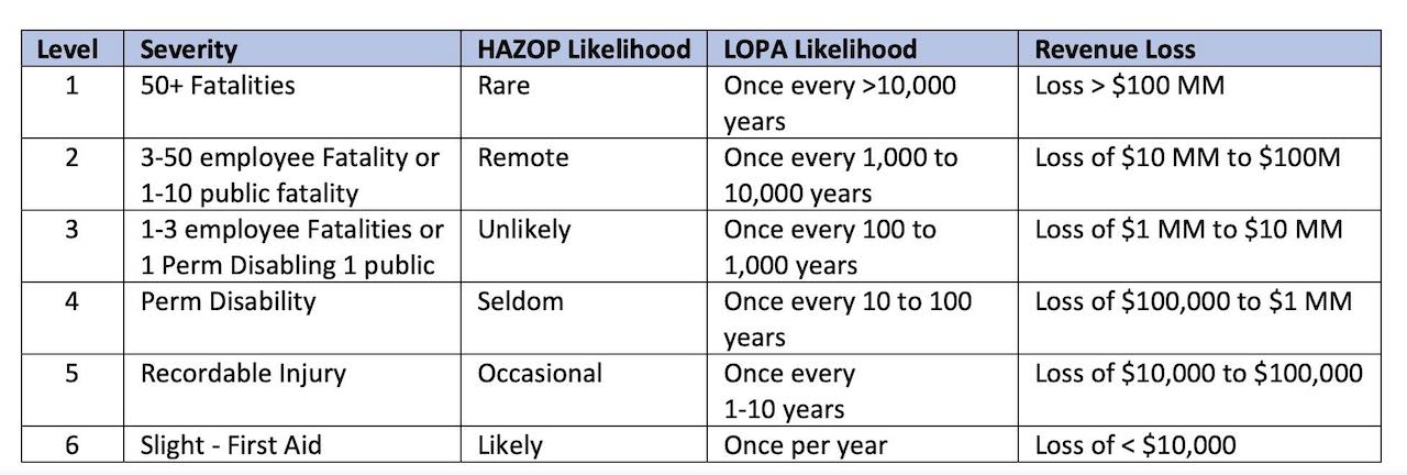

A risk waterfall matrix determines the severity and likelihood of each risk relating to HAZOP and layers of protection analysis (LOPA). A good matrix defines each level as an order of magnitude different than the previous level. For example, a recordable injury is 10 times worse than a first aid incident. In addition, HAZOP and LOPA likelihood results are different in that HAZOP uses subjective terms (i.e., remote) while LOPA results are more quantitative (i.e., once every 1,000 to 10,000 years).
Risk Matrix Levels and Definitions
