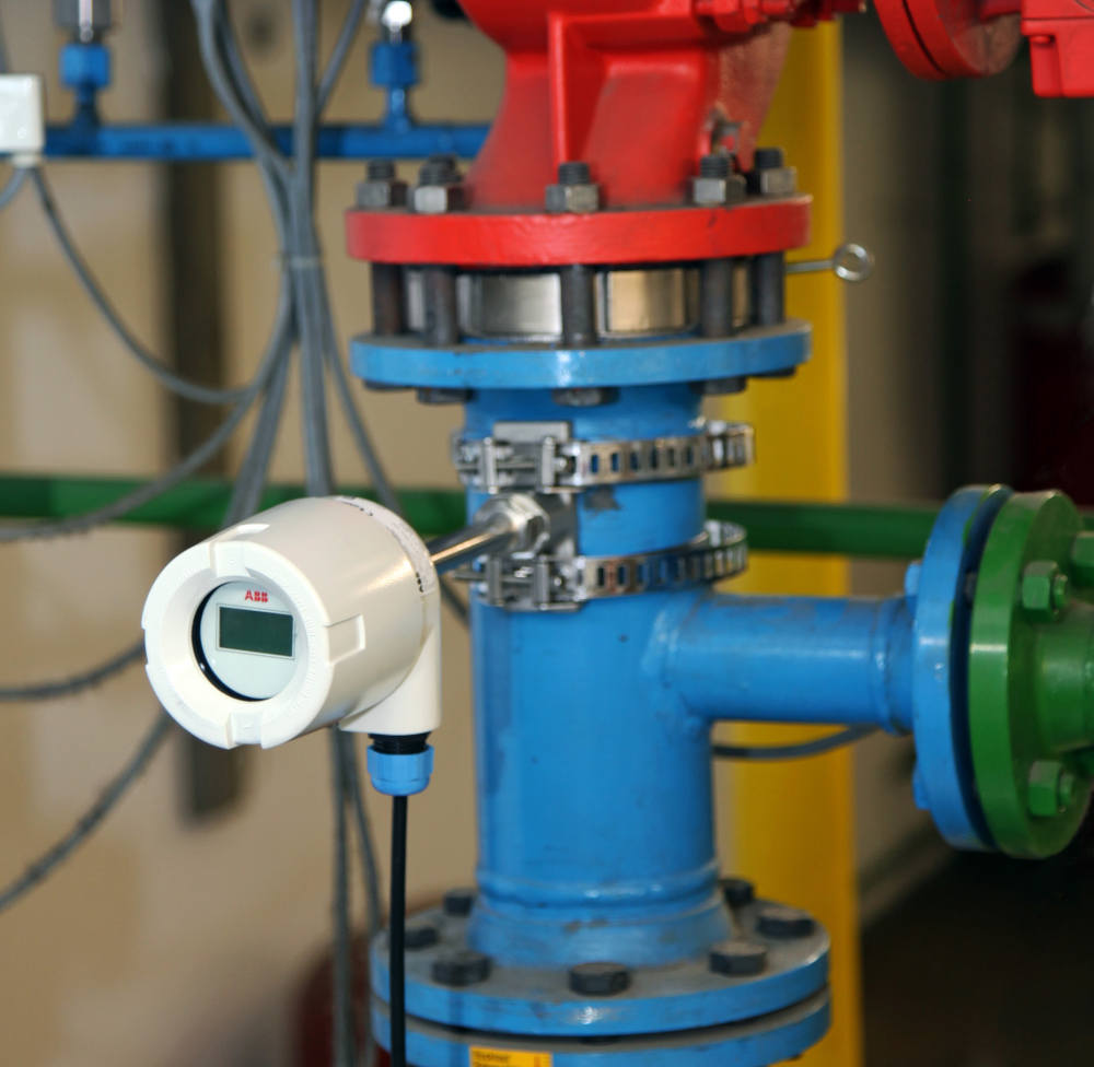

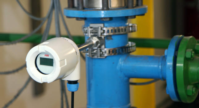

However, a new solution has emerged that allows operators to understand the thermal nature of the material inside the pipe without the need to drill into it and requiring no physical contact between the sensor and the medium. ABB’s TSP-341 noninvasive temperature solution treats the pipe itself as the sen­sor, taking readings from the surface and then using software to predict the true medium temperature based on variables such as ambient conditions, insulation and process and medium variables like volume, pressure and viscosity (see Figure 1).
Figure 1: ABB’s TSP-341 noninvasive temperature solution treats the pipe itself as the sensor, taking readings from the surface and then using software to predict the true medium temperature based on variables such as ambient conditions, insulation and process and medium variables like volume, pressure and viscosity. Courtesy: ABB Measurement & Analytics
The software interprets the readings from dual sen­sors — one measuring the temperature of the pipe wall, the other measuring the ambient temperature — and uses the resulting data to calculate and output the process temperature in real time. By taking the ambient conditions during the measurement into account, the transmitter significantly increases the accuracy and the responsiveness of the pipe surface measurement. Coupled with models that predict the range of application of the sensor, i.e., liquid-like processes flowing in the turbulent regime in metal pipes, the performance matches that of a traditional invasive measurement.
