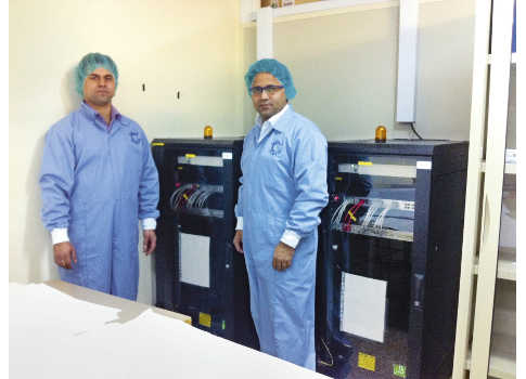

Saudi Pharmaceutical Industries & Medical Appliances Corp. (SPIMACO) is a great example of a company that has successfully implemented and designed an IIoT-ready network. To provide a new network solution for its Al-Qassim plant, the largest pharmaceutical plant in Saudi Arabia spanning 150,000 square meters, SPIMACO executed the five-step plan with great success. Project priorities included increasing efficiency, ensuring state of the art security, and optimizing resiliency and enterprise-wide scalability.
SPIMACO was able to consolidate the plant’s medicine manufacturing machines into one network, with a centralized manufacturing execution system (MES). A total of 500 IP nodes were installed on the panels outside the hygiene area, such as corridors and walkable ceilings, to communicate with the central MES. The solution included a full Gigabit network, equipped with Layer 2 switches and Layer 3 routers installed over multiple rings, which created a highly available infrastructure that was able to expand as needed.
The complete network, including installation and testing in accordance with pharmaceutical industry standards, was ready in only five days, and the design gave SPIMACO the security, availability, reliability and scalability needed to fully take advantage of, and prepare for, the new frontier of the IIoT. The IIoT is certainly a journey, not a destination. A safe and solid network requires consistent attention as its needs and vulnerabilities will evolve over time. These steps are designed to give teams a strong foundation as they migrate to an IIoT-ready network and realize the benefits and challenges that come from a highly interconnected world. Nils Buecker is a project manager in Belden’s industrial IT division.
