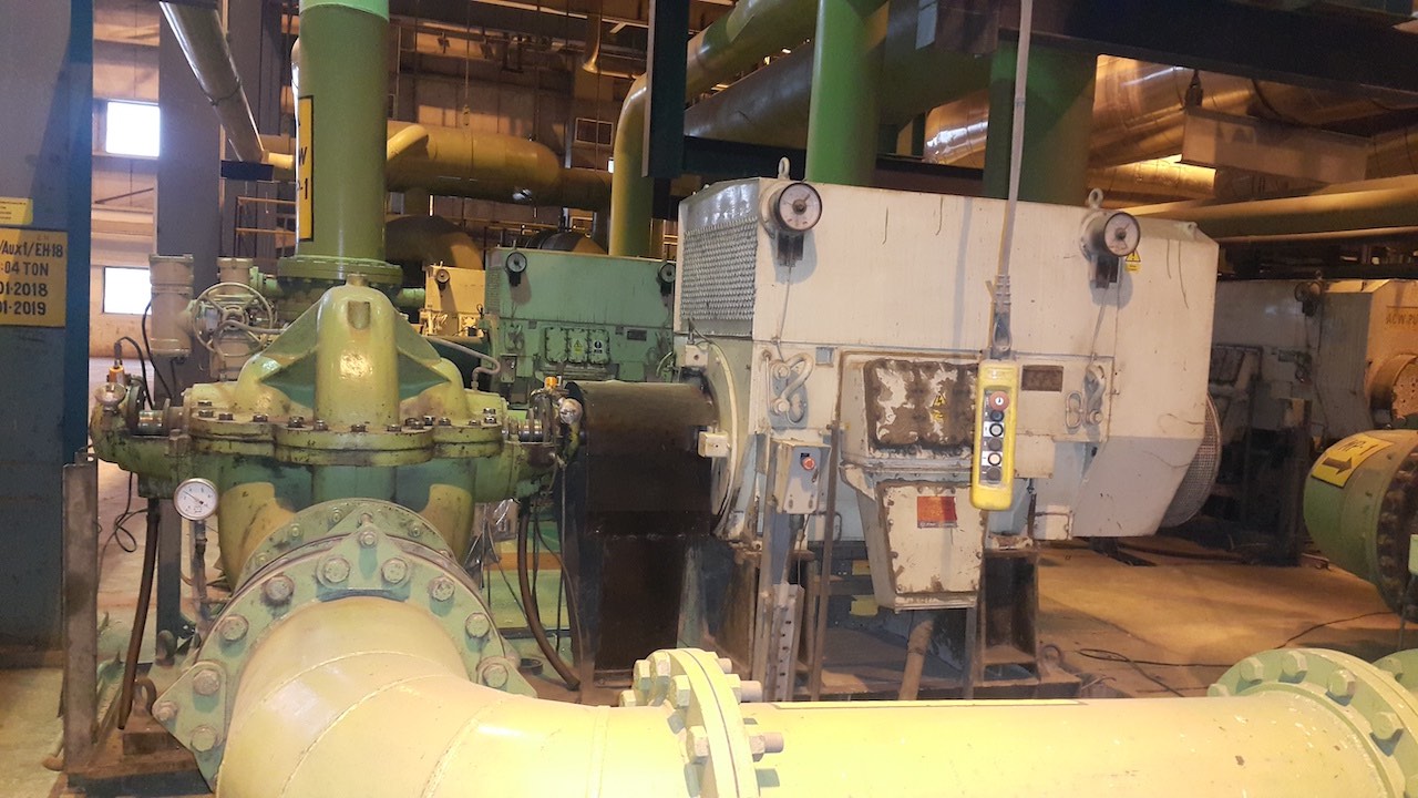

In power generation, pumps are key processing equipment. The condensate cooling-water pump is one of the critical-service pumps to maintain steady-state operations of the facility (Figure 4). It is a horizontal vane pump operating at up to 1,650m3/hour with a discharge of 9 MPa (62 psi) at 986 rpm. Each day that this pump is offline costs the power plant up to $250,000 in lost revenue. Unplanned maintenance and failure of this pump can incur repair costs exceeding tens of thousands of dollars.
The facility’s condensate cooling-water pump had chronic unscheduled downtime due to bearing failures from cavitation events. As the primary electric power provider for the region, reliability of the condensate cooling-water pump was a top priority at the facility.
To resolve failure conditions and increase unit uptime, plant engineers elected to install a real-time vibration monitoring and advanced AI-based predictive analytics solution on the condensate cooling-water pump. The new monitoring strategy focused on early fault detection of the pump and its components. Besides fault detection, this monitoring solution included AI-based algorithms to provide reliable RUL estimates before service interruptions occurred. To solve the bearing failure problems for this condensate cooling-water pump, several advanced wireless sensors were installed to monitor:

The monitoring system used secure Wi-Fi-enabled sensors to collect and upload vibration data continuously via the cloud. Cloud-based AI algorithms analyzed and tended the collected data.
Approximately six weeks after the installation of the advanced sensors and analytics system, the new monitoring program alerted maintenance staff that a vane fault had developed. It was causing cavitation problems for the condensate cooling-water pump. The plant’s maintenance staff verified the fault with a hand-held vibration monitor and did a partial disassembly to visually confirm damage to the pump vanes. A temporary repair of the damaged vanes was done before putting the pump back in service.
The advanced AI-based PdM system estimated a RUL of 25 days before total failure. This was sufficient time to schedule the pump replacement during an already planned maintenance outage. Applying AI-based predictive capabilities and advanced vibration monitoring, L&T Nabha Power avoided a serious pump failure and unplanned downtime. Early intervention reduced much needed repairs and minimized interruptions to facility operations.
