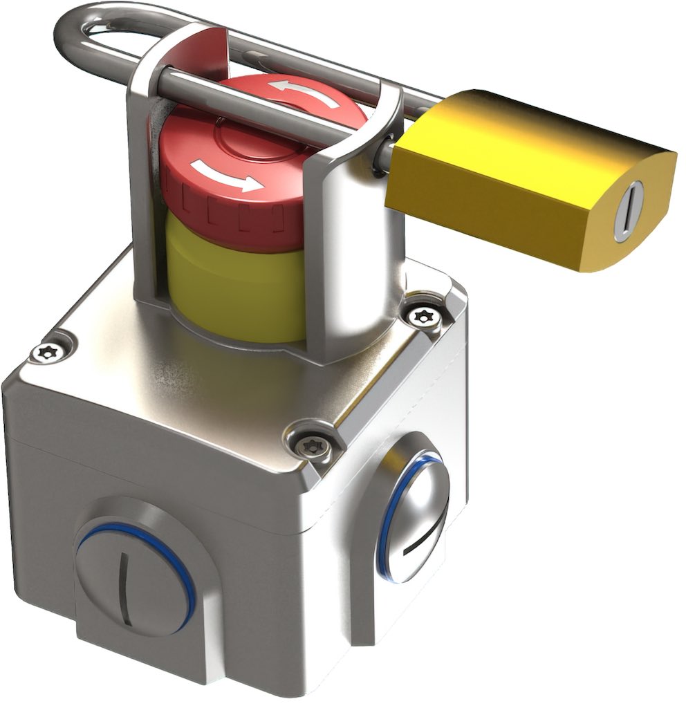

It seems electrical safety advances have reached a point of equilibrium with respect to results. However, there is still room for new technologies, along with an emphasis on improved designs and practices, to further reduce the frequency of electrical injuries (Figure 1).
Figure 1: Lockout/tagout devices are one of the best understood methods of placing equipment into a safe state, but there are many opportunities for applying intelligent devices and newer methods to improve worker safety. Courtesy: AutomationDirect

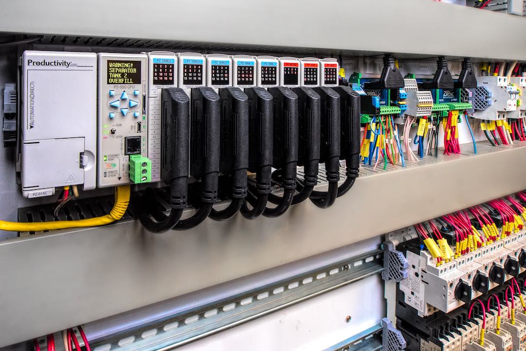

However, innovators and early adopters within several industrial and commercial vertical markets are deploying more advanced access control based on technology, networking and automation (Figure 2). The driving factors for these approaches are to improve risk mitigation, efficiency and speed.
Figure 2: Carefully applied automation, in conjunction with various safety-rated sensors, devices and emerging advanced technologies, serve to protect personnel and can also improve efficiency. Courtesy: AutomationDirect
