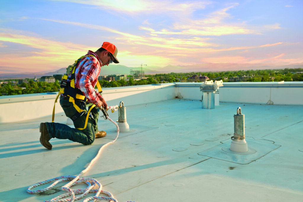

Fall protection equipment inspection requirements
OSHA requires all fall protection equipment to be inspected by the user before each use, referred to as the pre-use inspection. This inspection is performed to verify product labels are still intact, the equipment has not already arrested a fall and check for physical defects or issues that could cause failure during use. If the equipment fails inspection, users must report the equipment to their competent person to replace it before they begin work at heights.
OSHA also requires an annual inspection of all fall protection equipment to be performed by the organizationโ€™s competent person or a third-party ANSI-accredited fall protection equipment inspector. The annual inspection checks for all the same criteria as the pre-use inspection but is documented, so consistent records are kept for all fall protection equipment currently used by the organization. In the event of a fall incident, inspection records will likely need to be reviewed. The annual inspection must also document the equipment type (anchor, harness, lanyard, etc.), manufacturer, model number, date of manufacture, indication of pass/fail, date of inspection and the inspectorโ€™s name.
It should be noted that annual equipment inspections do not have to be conducted all at once, but every piece of equipment must be inspected by the competent person at least once every 12 months. Employers should know what federal or state OSHA program is relevant to their organization and if their requirements differentiate from federal OSHA. For example, In California, Cal/OSHA requires construction companies to perform this documented inspection once every six months for each piece of equipment.
Courtesy: Diversified Fall Protection
