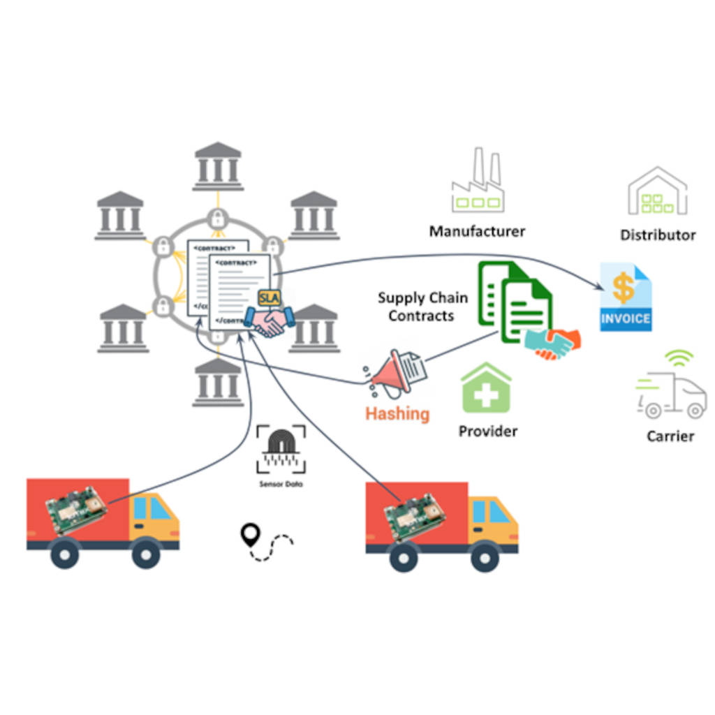

As shown in the figure, AuthTrail leverages a consortium blockchain to store and exchange all the information related to freight contracts, real-time locations, climatic conditions, transportation and handling of physical assets, thereby creating a single source of truth available to all stakeholders in the system and eliminating potential issues like late reconciliation, improper handling of assets, etc.
Moreover, secure edge devices ensure trustworthiness of the data collection for the status of the attached physical assets. In particular, trusted real-time IoT data will be fed into smart contracts, which specify the service-level agreements (SLAs) negotiated among stakeholders, for evaluation periodically and the penalty settlement will be triggered automatically in the event that an SLA is breached.
Finally, to create the chain of custody when assets are moving in the supply chain, AuthTrail requires the stakeholders to record standardized EPCIS events on the blockchain whenever the status of assets changes.
AuthTrail asset tracking framework
Figure. A high-level system architecture for AuthTrail. Image: IIC
