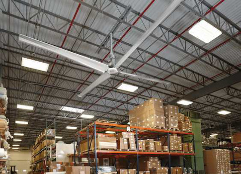

A large 24-foot diameter HVLS fan gently moves large volumes of air up to 22,000 square feet and replaces 10 to 20 floor fans. By mixing air, HVLS fans also help air-conditioning systems work more efficiently, allowing them to be operated at a set point up to five degrees higher.

HVLS ceiling fans mitigate the rising heat effect by gently moving the warm air near the ceiling back down toward the floor where it is needed. The air reaches the floor below the fan where it then moves horizontally a few feet above the floor. The air eventually rises to the ceiling where it is cycled downward again. This mixing effect creates a much more uniform air temperature, with perhaps a single degree difference from floor to ceiling. Facilities equipped with HVLS fans lower the burden on the heating system, reduce energy consumption and save money.

Some of the variables in these ROI calculations include obstructions such as pallet racks, machinery and product staging, personnel work areas, and overall building layout, to name a few. Larger diameter fans will move air further down rack aisles and over obstructions. Smaller diameter fans can be most effective in specific work areas, or where installation space is limited.
