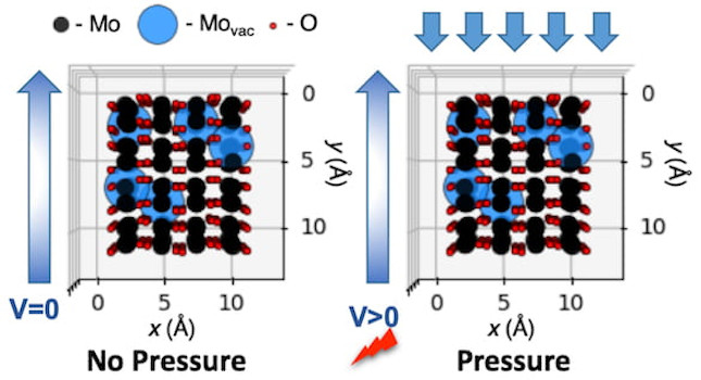

The researchers at Rice’s Brown School of Engineering found their micron-scale flakes exhibit a piezoelectric response that is as strong as that observed in such conventional 2D piezoelectric materials as molybdenum disulfide.
The key appears to be defects that make molybdenum dioxide’s crystal lattice imperfect. When strained, the dipoles of electrons trapped in these defects seem to align, as with other piezoelectric materials, creating an electric field leading to the observed effect.

“Molybdenum dioxide isn’t expected to show any piezoelectricity,” added Rice postdoctoral researcher Anand Puthirath, a co-corresponding author of the paper. “But because we’re making the material as thin as possible, confinement effects come into the picture.”
He said the effect appears in molybdenum dioxide flakes grown by chemical vapor deposition. Stopping the growth process at various points gave the researchers some control over the defects’ density, if not their distribution.
