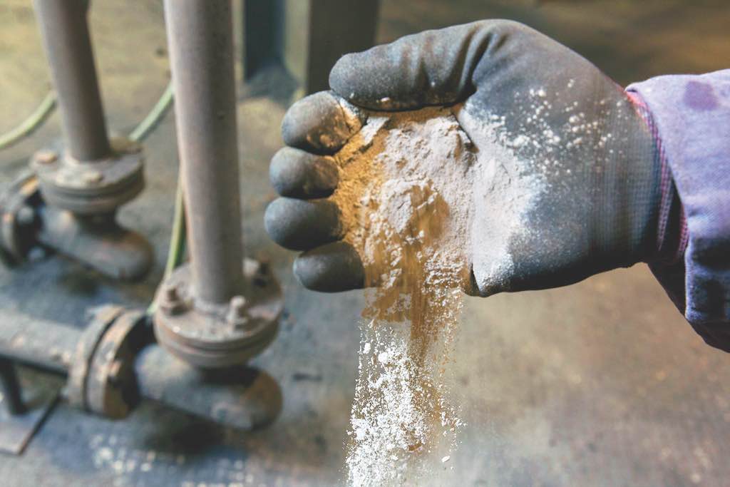

“We use pneumatic conveying systems to move metallic additives into ladles, and transport sand and sand additives to our core rooms,” said Mike Hemmila, plant manager. “We also use pneumatic conveying to transport metallic waste and waste sand back into the silos, and we use it in our dust collection systems.” The pipelines are 2 or 4 in. in diameter and 30 to 300 ft long.
With a near-constant stream of abrasives moving through the lines at high speed, wear is a major design and maintenance consideration. Line integrity is especially critical at the bends, where a change in direction can cause the material to impact and wear-through elbow walls resulting in blowouts.

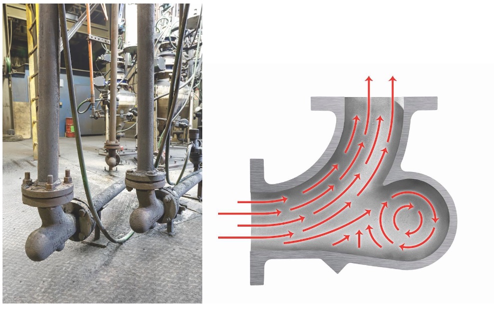

Figures 1a and 1b: A spherical vortex chamber protruding from the elbow diverts part of the flow where it forms a loosely packed mass that slowly rotates in the direction of flow, gently deflecting particles around the bend. Courtesy: Waupaca Foundry
Extending the service life of pneumatic system elbows
To extend the service life of the pipeline bends and minimize downtime, Waupaca deployed deflection elbows from HammerTek Corp., Bethlehem, PA. The company’s smart elbow design features a spherical vortex chamber protruding from the elbow. When material passes into the elbow, part of the flow is automatically diverted into the vortex chamber, where it forms a loosely packed mass that slowly rotates in the direction of flow. This gently deflects incoming particles around the bend.

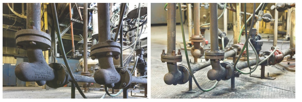

Figures 2a and 2b: Waupaca Foundry deploys Smart Elbow deflection elbows to avoid leaks, blowouts and downtime from wear by abrasive materials speeding through the pneumatic lines. Courtesy: Waupaca Foundry
Hemmila also noted that this system has provided reliable service since 2004.
The smart elbows also are suited to applications at Waupaca in which materials are diverted downward into silos and bins. “Dead-end stops are a good application for them as the material absorbs the impact as direction changes.”

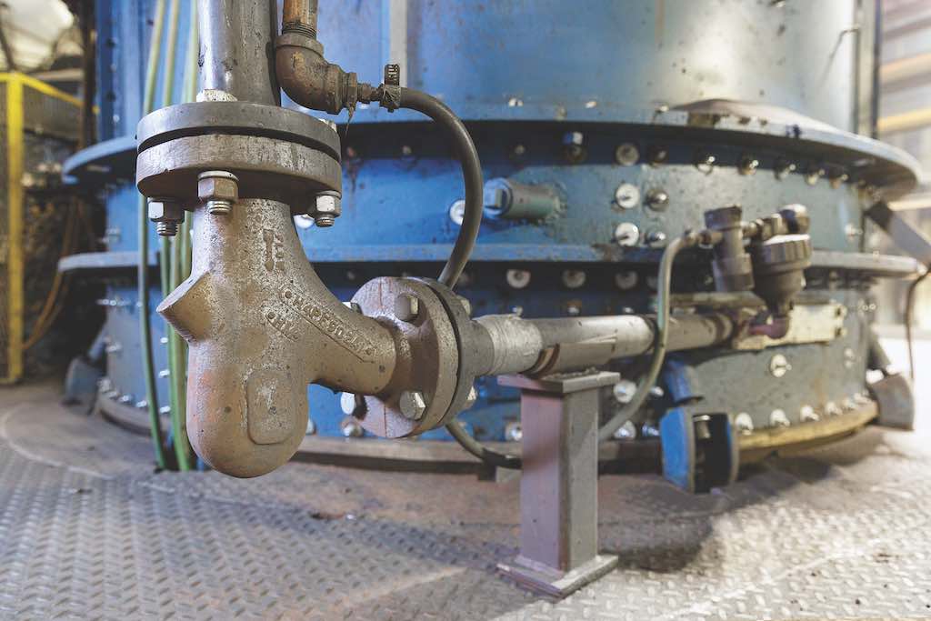

Figure 3: Among several applications, short radius deflection elbows at Waupaca Foundry find use at dead-end stops where materials are diverted downward into silos and bins. Courtesy: Waupaca Foundry
Dale Harris, maintenance foreman at Plant 2/3, said, “We have some HammerTek 45º elbows that can last two years.”
Replacing a smart elbow bend is simple, Harris said, being a matter of changing eight bolts, with most jobs taking several minutes. If the leak occurs in a very high area or is otherwise difficult to access, it might take an hour to replace because of the time needed to round up a lift, hoist and other equipment.
