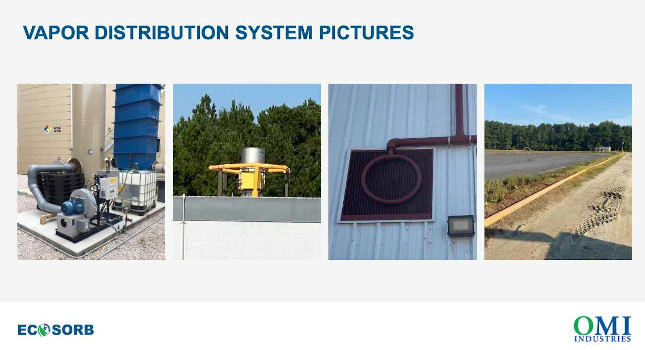

McLaughlin: With Ecosorb, vapor systems there is no heating required in the ducting. The only heat requirement is for the Ecosorb container and the vapor system, which can be completed with placement inside a current building or a heated shed.

McLaughlin: Yes, OMI Industries designs, engineers, and builds all technology required for systems using Ecosorb chemistry.
