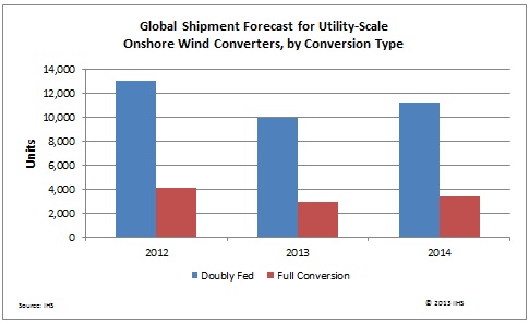

The global market for utility-scale onshore wind converters continues to be led by doubly fed (DFIG) converters, according to a new report entitled “The World Market for Wind Converters – 2013” from IHS Inc.
DFIG converters are forecast to outpace full-conversion products by a compound annual growth rate (CAGR) of 1.6% from 2012 to 2017, reaching more than 9,900 units shipped in 2017. Three major factors are hindering the sales of full-conversion products in the converter market: high rare earth material prices, lagging offshore wind development and China’s high demand for doubly-fed converters.
