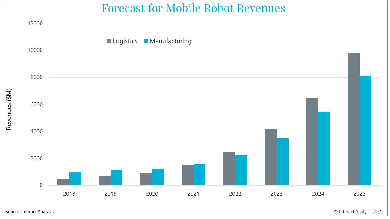

Sales of mobile robots are growing more rapidly in logistics. Courtesy: Interact Analysis
