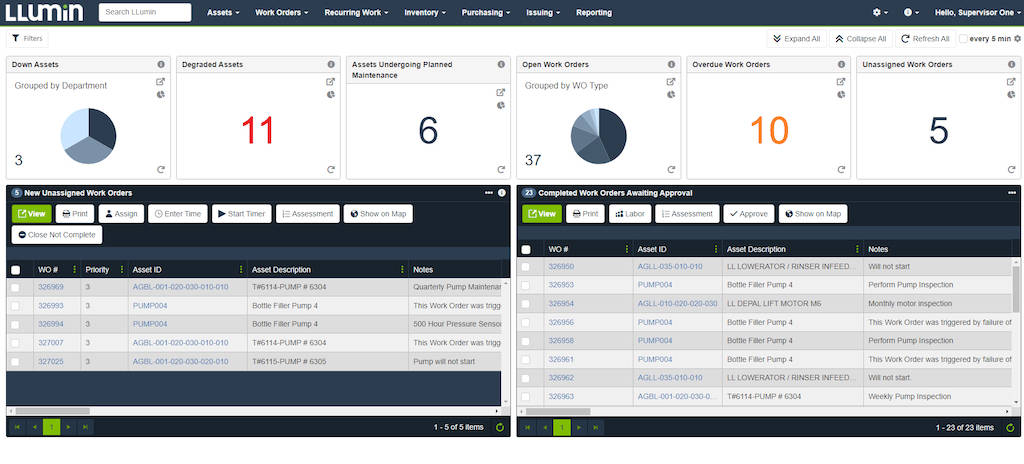

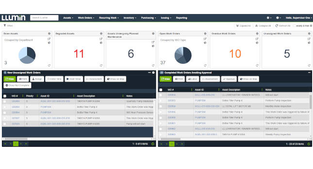

Danielle Newsome: Skilled workforce shortages continue to impact manufacturing facilities, who struggle with the ability to allocate the resources needed to improve their asset management practices. You have the data, now what do you do with it? Lack of resources or bandwidth to review and use that data to make informed decisions is a challenge for many.
Quality data and access to the data can also hinder the ability to support effective asset management. Organizations can lack effective technology and system integration making it difficult to evaluate several tasks related to asset management, such as storeroom/inventory management, repair history and life cycle management.
Llumin asset management and predictive maintenance computerized maintenance management system software example. Courtesy: Llumin
