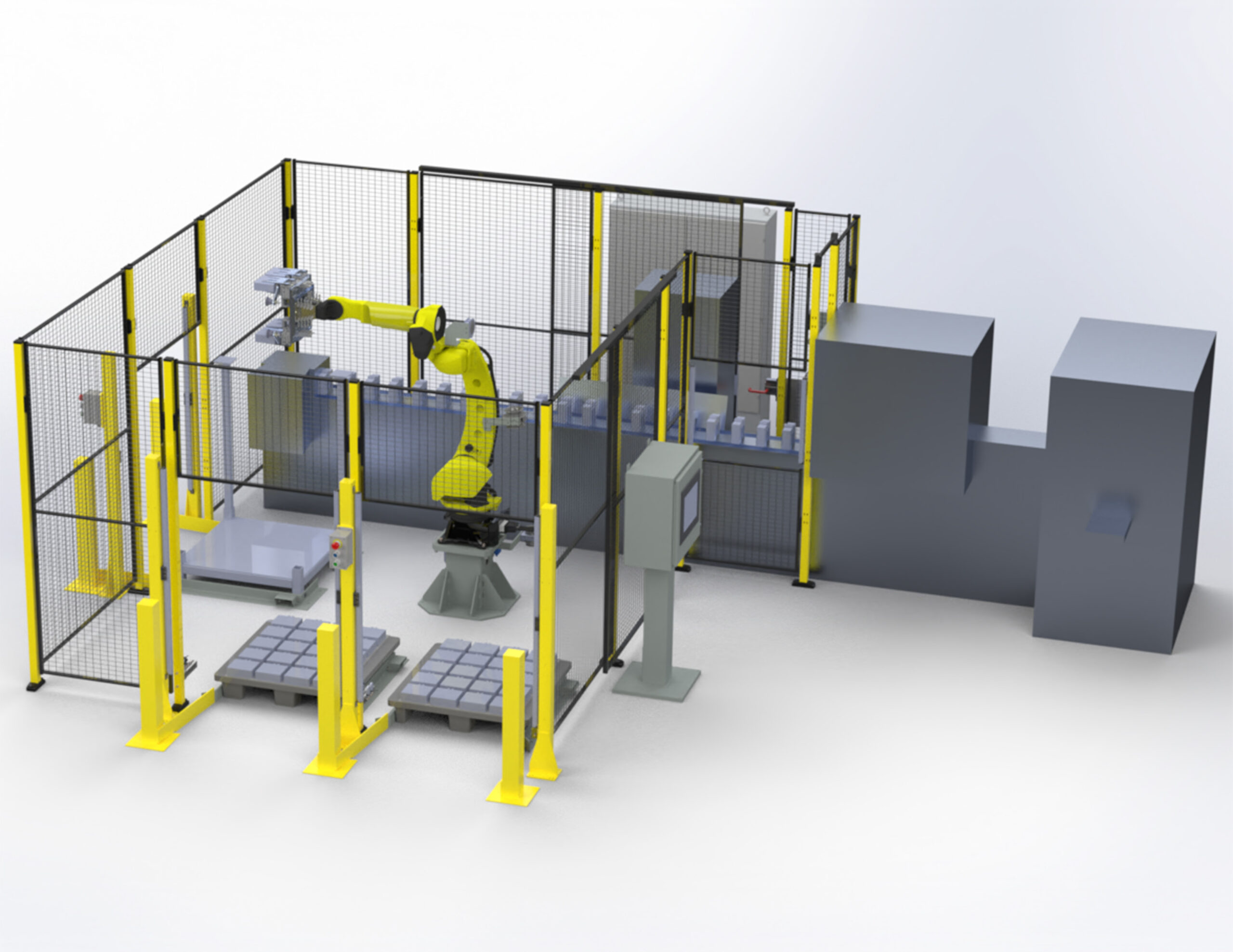

Consider the case of a large battery manufacturer, which required machine-to-machine transfer of stacks of metallic plates, a process duplicated across many of its facilities. This ergonomically challenging and hazardous work environment presented a great opportunity for automation. Concept Systems utilized their evriiRobot platform to provide a tailored solution for this application (see Figure 1).
Figure 1: Virtual representation of the configured evriiRobot workcell. Courtesy: Concept Systems, Inc.

With more than 25 repeat instances and stringent rate requirements, a standardized work cell platform made sense for this situation.
There were several challenges in trying to address the client’s automation needs:
  • Spatial: Extremely tight working conditions with operation near major footpaths required tight safety design to limit downtime events.
  • Continuous flow: Upstream equipment operated continuously with no scheduled downtime events for replacing completed pallets.
  • Product orientation: Product exited the upstream equipment in a vertical orientation with a horizontal orientation for palletizing.
  • Product flexibility: Product exiting upstream equipment was not rigidly constrained and had the capacity to shift during operation if not properly grasped.
  • Product variability: A range of products are processed requiring a scalable solution that can handle product variations and enable additional recipes to be added.
  • Cycle time: Complete palletizing cycles were required to be processed at a rate of less than 4 seconds per part.
Concept Systems iterated the robot platform’s tool and safety design to accommodate project-specific requirements. This approach allowed for continuity in human-machine interface (HMI), software, mechanical and electrical design while still tailoring the solution to this particular application.
The design utilized five entrance locations and a remote operator interface for localized control capability. Two entrances have sliding doors equipped with clean-in-place (CIP)-safety enabled multi-function access boxes (MFAB) door interlocks to allow for low-volume operator interaction. The remaining interaction points were CIP-safety enabled high-resolution light curtain access positions.
This non-physical safety interface allowed operators to remove palletized products during operation without interrupting automatic sequencing. This compact work cell fit in the existing operating area without impacting established foot traffic or peripheral operations (see Figure 2).
