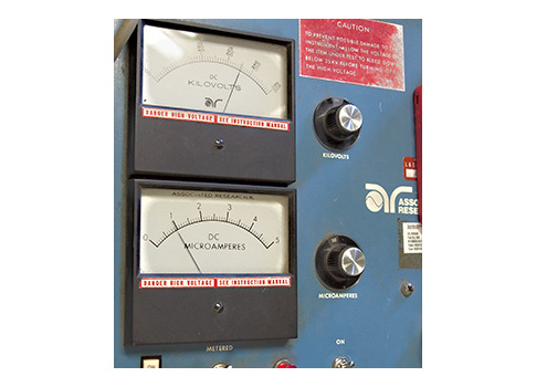

When looking at cable testing, there is confusion sometimes because IR testing is like PI testing. The two test work well together. Seeing deterioration during an IR test provides justification to perform the PI test.
They both use the same voltage, but there is one primary difference between the two: time. IR testing lasts one minute. PI testing takes over ten minutes. Those extra nine minutes provide more detail about any current conduction or leakage current.

The PI test is reliable and provides accurate results. These results make it important in determining the performance of motors. PI testing equals the ratio of 10-minute to 1-minute IR value of a machine’s windings. Test any motors with the high index for their windings. In the case of induction motors, 2.0 is the value of the smallest PI.
