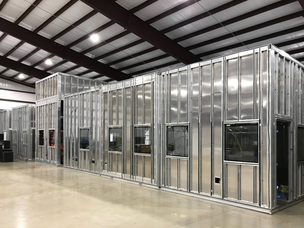

2. Cleanroom facilities.
cleanroom facilities
Cleanroom fabrication at G-CON in College Station, TX. Courtesy: IPS
Based on the request for mobility with the vaccine facility, the IPS project team reached out to trusted partner firm, G-CON, who specializes in the manufacture of modular cleanroom facilities commonly referred to as point of delivery (PODs). This cleanroom facility was more technically complex than previously designed and constructed modular cleanrooms. For example, the production area included a piece of process equipment that weighed 30,000 lbs. and required a 15-foot clear room for installation. The end result was a 3,000 square feet layout consisting of six 12 feet x 50 feet x 13 feet shipping sections and a smaller high-hat area. The layout was optimized to minimize process utility runs across the shipping sections while maintaining the space’s required functionality and regulatory requirements. The modular cleanrooms’ fabrication involved approximately 31,300 shop labor hours with 5,200 hours of on-site install. The end result was over 85% of project hours were moved off-site contributing to a higher quality and safer installation. Due to the inherent nature of shop work, it is estimated that 20% of labor hours were eliminated (a further savings of 6,260 man-hours).

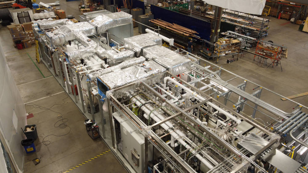

3. Modular mechanical room.
super skid
Modular super skid in fabrication at H.T. Lyons in Allentown, PA. Courtesy: IPS
The client originally asked that the project team design and construct a traditional mechanical room for the facility, but upon award of the project, the IPS team recommended that the mechanical room be fabricated off-site, then assembled on-site. IPS again reached out to a trusted partner, H.T. Lyons, to assist in designing and fabricating the mechanical super skid. The end result was a 23 ft. x 90 ft. mechanical room consisting of four modules and a loose ship chiller. H.T. Lyons received and installed multiple pieces of equipment for installation on the super skid, including a makeup air unit, air compressor, waste neutralization system, WFI & clean steam skid (including pretreatment), CIP skid, as well as all of the electrical distribution equipment. H.T. Lyons took responsibility for all ductwork and piping between the mechanical super skid and the G-CON cleanrooms with all spool pieces and support steel prefabricated and shipped to site for installation after both the cleanrooms and super skid were set in position. H.T. Lyons spent 8,100 hours in the shop to construct the mechanical system. An additional 2,230 hours were spent installing the mechanical system in the field. They estimate a 50% savings in hours by performing the work in the shop (4,050 hours) instead of in the field where there would have been constant coordination with competing trades. By executing this work in a modular fashion, the project team moved more than 78% of the work hours off-site.

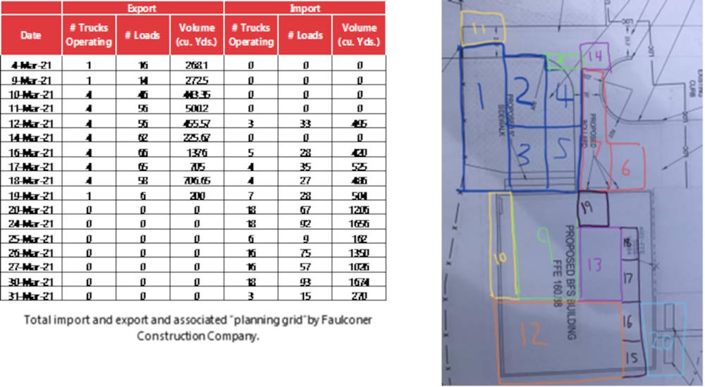

Erection of the pre-engineered metal building
planning grid
Total import and export and associated “planning grid” by Faulconer Construction Company. Courtesy: IPS
The building erection involved tree removal, extensive removal of unsuitable soils, pouring the slab, erecting the steel, and installing the shell. Because of the site change, the building became the critical path for the project. Due to the site’s swampy natural environment, the site work contractor, Faulconer Construction Company, had to remove over 7,000 cubic yards of unsuitable soils and import over 11,000 cubic yards of clean fill. In order to maintain schedule, our team tracked daily truckloads in and out; and challenged the team to be more efficient and identify opportunities to increase daily productivity. The site-work team from Faulconer Construction optimized the volume of trucks, routing of delivery, and soil removal to reach a peak efficiency. The cumulative number of truckloads in and out more than doubled based on learned efficiencies from start to finish. These efficiencies contributed to a savings of 12 workdays. The table and zoning diagram show how the team improved efficiency by breaking the site down by required excavation depth and reinstall requirements. The table shows that while there were many factors associated with loading and unloading operations, including weather, access challenges, and other on-site work, the team showed continuous improvement by planning and reviewing the daily results.
After the foundation, slab on grade, and footers were poured; the project team focused on efficiently erecting the building. The team used a grid pattern to isolate the 16,000 square foot building into equal work areas and ensured that all trades could move forward without interfering with other disciplines.  The building erection crew had extensive experience installing pre-engineered metal buildings and translated that experience into efficient fieldwork by organizing the components to quickly put into position as they were needed, despite the need for other trades to be in the area. This allowed the main structure to be erected quickly and enabled the crew to move to the standing seam metal roof immediately.  After the roof was approximately one-third installed, the fire protection and electrical contractors began working to install lighting and fire protection with the mechanical and plumbing contractors.  This allowed the project team to finish overhead rough-in work less than 20 workdays after completing the roof.

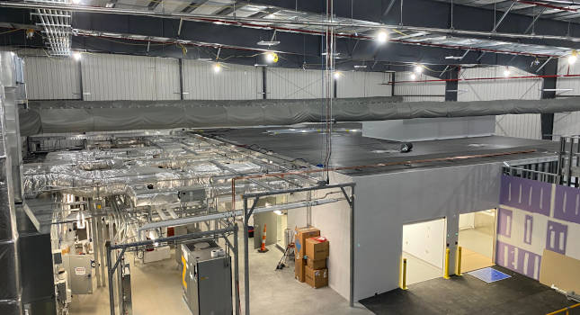

While the crew was installing the roof, a subset of the building crew began working on erecting the exterior metal wall panels, allowing the electricians to follow with rough-in for wall-mounted devices (fire alarm, outlets and security). To further accelerate the project and eliminate the need for on-site labor, the project team chose to leverage a fabric duct manufactured by DuctSox. This product is sewn off-site and is hung using a cable stretched across the building. This reduced total installation time by approximately 5 weeks and allowed for flexibility to rig the modular equipment into the space.

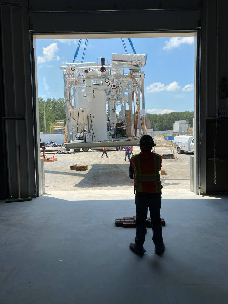

Receipt of modular equipment
rigging
Rigging of Super skid into the building. Courtesy: IPS
With all of these efforts, the project team had the building dried-in on early summer and was ready to receive the PODs on three weeks later (11 months after the initial order placement). By accelerating the dry-in and overhead fit-in, the team kept the process equipment on the critical path. By leveraging the modular structures, our team energized the both the super skid and PODs and flooded the utility systems two weeks after receipt of the PODs. With extensive coordination and planning, the deliveries of the super skid occurred over two days. By synchronizing the rigging and setting of both the super skid and the PODs, the project team eliminated a second crane mobilization and leveraged the knowledge of its team members to ensure the structures were set in the proper locations. All connections were coordinated and discussed, eliminating the need for one of the crews to mobilize early to assist in this coordination.
