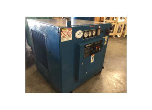

Both oil injected and oil-free rotary screw compressors are well suited for energy conversion. Usually an oil injected type compressor operates at as high as 185 F or more, while the oil-free design exceeds 300 F. They release warm air, which can be harnessed by integrating the compressor system with standard HVAC (Heating, Ventilating, and Air Conditioning) dust work and controls.
The warm air coming out of the compressor can effectively be used for space heating. Simple methods, such as transferring the warm air generated to an area that requires heat can accomplish many purposes. This can be done by passing air across the after-cooler and lubricant cooler of the compressor. This improves air quality, extends lubricant life, and minimizes back pressure on the cooling fan of the air compressor.
Another useful application of rejected heat coming from air-cooled or oil-injected compressors is heating water or other process fluids. The compressor itself discharges water, which is as hot as 160F. The discharged hot water can be directly connected to the process that required continuous heating.
