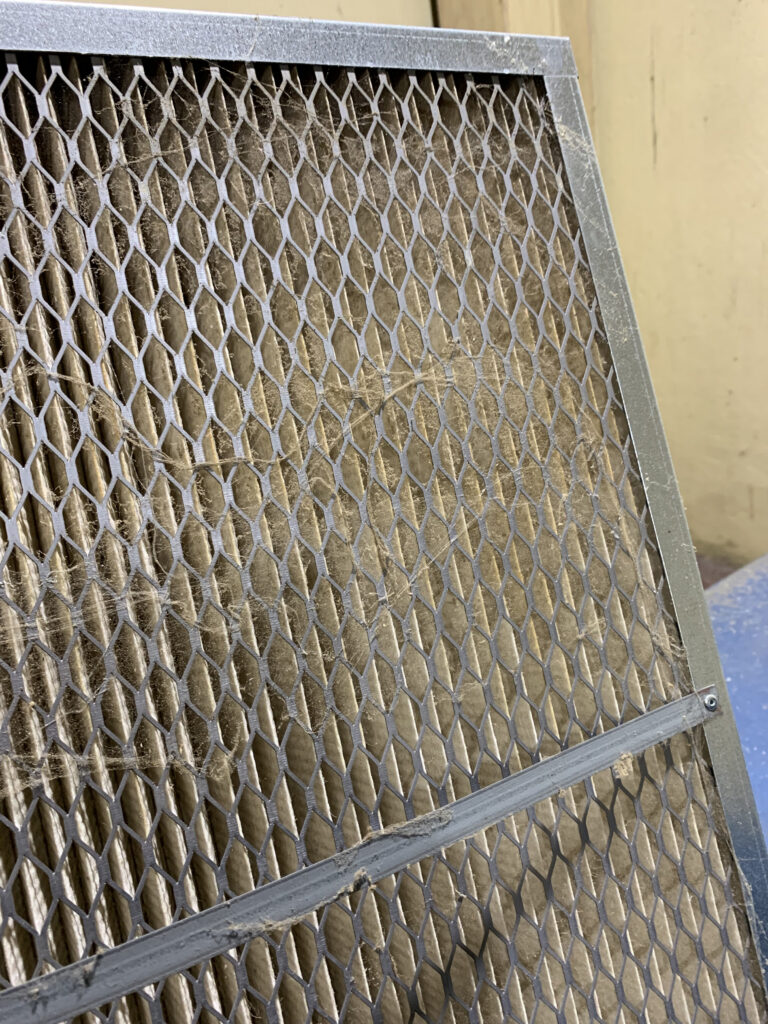

Compressed air quality: particulate contamination
Particulates in both ambient and within the compressed air system are a concern for many applications. High particulate environments include mining sites, paper manufacturing, cardboard production and textile manufacturing.
Compressor intake filtration is specifically designed to protect the tight tolerances found in compression chambers, which can be as tight as 0.001 to 0.002 inches. Intake filter elements must be designed to filter for particulate as small as 1 micron. When subjected to high particulate environments, the filter element lifespan can be reduced from three to six months to a few hundred operating hours, which can increase maintenance costs.
When high particulate exposure is unavoidable, one option is to prefilter the air entering the compressor room or remotely locating intake filters away from high particulate concentration sources. Accounting for these measures early in planning can save time and money.
Here’s an example of the consequences of not accounting for the inlet location: A container manufacturer installed compressors in the center of the facility. The area appeared to be clean and the production equipment did not produce much particulate matter. Soon after operation began, the compressor’s controller displayed a high oil/air separator pressure drop warning.
The filters, designed to last a year under continuous 24/7 operation, had to be replaced at a cost of over $1,000 per compressor and the new filters showed contamination within a few hundred hours. Investigation found the compressors were drawing intake air from the receiving dock over 100 feet away, where idling delivery trucks discharged exhaust just inside the building. Relocating the compressor intake filter housings to the roof resolved the contamination problem caused by diesel exhaust particulate (see Figure 4).
Other particulate sources may also include rust, pipe scale and microbes. Proper filtration between compressed air system components (compressor, dryers, tanks, etc.) helps ensure ISO-level air quality is maintained.

Figure 3: Example of a dirty air inlet filter during service. When subjected to high particulate environments, its lifespan can be reduced from three to six months to a few hundred operating hours. Courtesy: Hitachi Global Air Power
