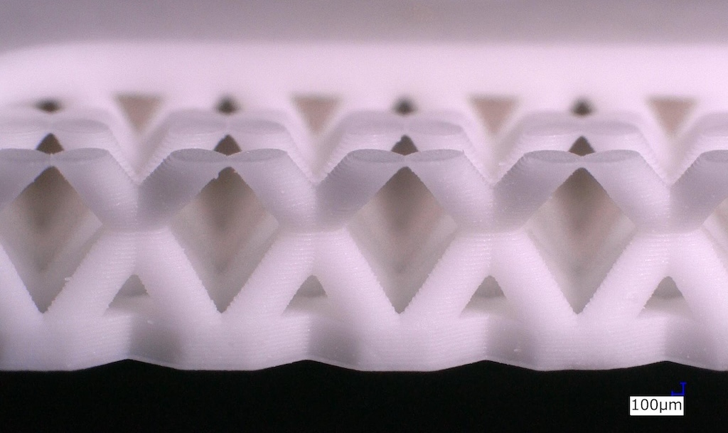

Shashin Kagaku is a Japanese manufacturer of AM systems that form high precision parts using a ceramics-based process. Their AM system uses aluminum oxide powder mixed with a resin to form a slurry that is cured under UV light. This is then used to build up parts layer by layer by using UV light to cure the photosensitive slurry into the required form. Finally, a kiln fires the parts, evaporating the resin and making them durable enough for real applications via sintering of the ceramic powder.
Shashin Kagaku is a Japanese manufacturer of AM systems that form high precision parts using a ceramics-based process. Courtesy: Shaskin Kagaku, CC-Link Partner Association (CLPA)
This 3D printer can manufacture large-scale parts with dimensions exceeding 600 mm square and 300 mm deep, while maintaining manufacturing tolerances on the scale of thousandths of mms. To do this, extremely fine motion control of a variety of rotary and linear axes in an interpolated manner is required. These also need to operate at high speed to meet the necessary productivity targets.
