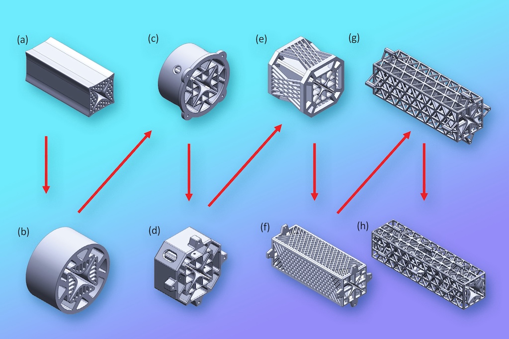

Because additive manufacturing allows the researchers to easily try new designs, they created a number of different quadrupole filters before arriving at the final iteration (h), which is surrounded by a series of triangular lattices to provide durability.
Because additive manufacturing allows the researchers to easily try new designs, they created a number of different quadrupole filters before arriving at the final iteration (h), which is surrounded by a series of triangular lattices to provide durability. Courtesy: Massachusetts Institute of Technology (MIT)

Since the 3D printer can form practically any shape, the researchers designed a quadrupole with hyperbolic rods. This shape is ideal for mass filtering but difficult to make with conventional methods. Many commercial filters employ rounded rods instead, which can reduce performance.
They also printed an intricate network of triangular lattices surrounding the rods, which provides durability while ensuring the rods remain positioned correctly if the device is moved or shaken.

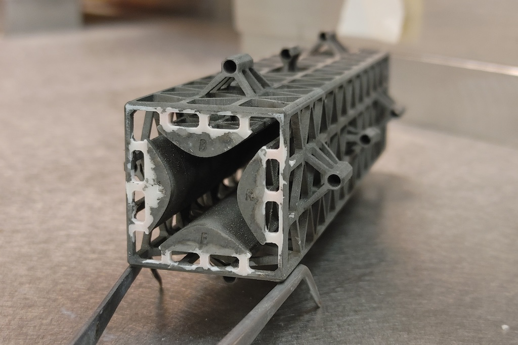

This photo shows an example of a 3D printed miniaturized quadrupole mass filter. They can be fabricated in a matter of hours for a few dollars.
This photo shows an example of a 3D printed miniaturized quadrupole mass filter. They can be fabricated in a matter of hours for a few dollars. Courtesy: Massachusetts Institute of Technology (MIT)

Since the 3D printer can form practically any shape, the researchers designed a quadrupole with hyperbolic rods, as shown in the figure. This shape is ideal for mass filtering but difficult to make with conventional methods.
Since the 3D printer can form practically any shape, the researchers designed a quadrupole with hyperbolic rods, as shown in the figure. This shape is ideal for mass filtering but difficult to make with conventional methods. Courtesy: Massachusetts Institute of Technology (MIT)
