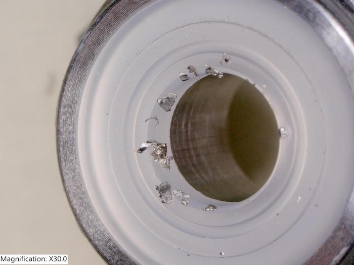

Creep occurs immediately after regulator installation when debris flows through the system. The contaminants create a fine gap between the regulator’s seat and poppet, which can inadvertently cause system media to flow across the seat. The result is unwanted pressure increases downstream, which can be dangerous if the downstream components are not rated to handle the higher pressures. Fortunately, creep can be avoided with careful installation, upstream filtration, and the purchase of a spares kit with new regulators.

A particulate stuck in the regulator’s seat may allow pressure and flow to escape – or creep – across the regulator’s seat when it should otherwise be closed, resulting in an unwanted downstream pressure rise. Courtesy: Swagelok

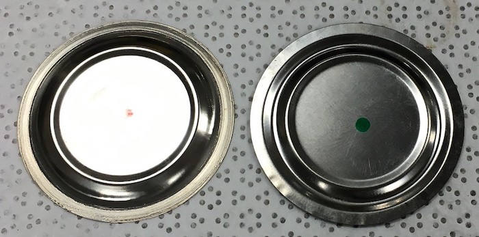

For example, advisors may discover the regulator’s diaphragm is distorted or cracked.
A diaphragm may become distorted due to excessive downstream pressure. and no longer contact the poppet, so no flow can move through the regulator. Courtesy: Swagelok

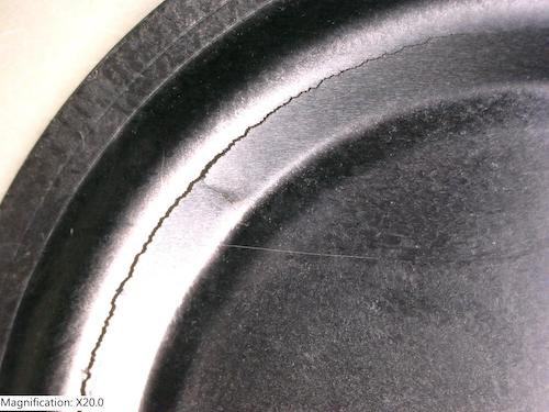

A cracked diaphragm will have reduced sensing – and therefore pressure control – capabilities. Courtesy: Swagelok
Excessive downstream pressure can cause a diaphragm to distort, particularly around its rim where the spring cap and body hold it in place. The distorted diaphragm may no longer contact the poppet and therefore not be able to actuate it, resulting in no flow moving through the regulator. Chemical attack or cycle fatigue from pulsations may cause a diaphragm to crack and/or form a hole, which will compromise its pressure-control capabilities. Knowledgeable suppliers will know if a diaphragm needs to be replaced as well as how to mitigate the underlying issues that caused the damage in the first place.

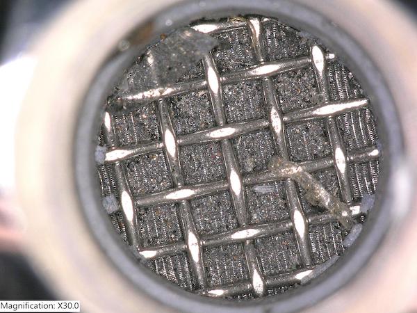

The above issues are just a few of the most common causes of poor regulator performance, but there may be additional factors unique to a specific application that can adversely influence outcomes as well. Even a clogged filter may be the culprit, with a simple cleaning or replacement being all that is needed to get a system back to running properly.
Cleaning or replacing a clogged filter may be a simple fix to restore diminished pressure. Courtesy: Swagelok
