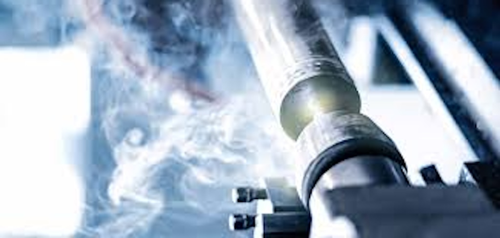

Figure 1: An example of poor air quality from computer numerical control (CNC) machining operations. Courtesy: Bee Clean Specialties
