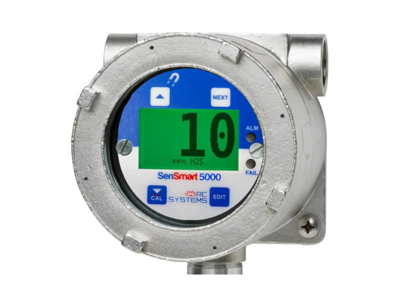

Figure 1: An example of what a gas detector can look like in the food industry.
Figure 1: An example of what a gas detector can look like in the food industry. Courtesy: R.C. Systems Inc.
