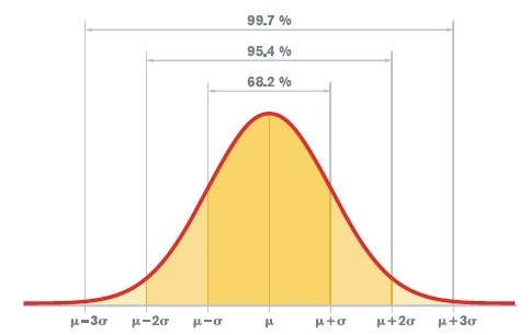

When alarm limits are not set by OEMs, equipment operators can determine alarm limits either statistically based on manufacturer, model or oil type, or they can be trend based. Combining both statistical and trend-based approaches is synergistic. For example, Zabawski notes that a limit tends to be static, only applying as a threshold near the end-of-drain interval, while trend-based limits can spot abnormalities during all the mid-interval samples as well as at the end-of-drain samples. A rule of thumb is to set alarms lower when the oil volume is greater, the drain interval is shorter and/or if the speed or load is lower; however, there is no one limit fits all generalization.
Eckert notes that ASTM D7720 is the most common method for determining alarm limits and “is a good reference to use when developing alarm limits with in-service oil analysis data populations.”2 Regardless of how the limits are developed, Eckert says, “The best method is the method that accurately represents a ‘normal’ operating condition and does not produce false alarms.”
Williams says, “The calculation of alarm limits should initially be developed based upon a review of a statistically acceptable population of pertinent data along with data associated with failures (if available).” Williams recommends “a sampling study where the machine is under normal operating conditions and gathering at least four or five samples over time to develop a trend.” These data permit the development of averages for normal machine behavior to permit establishing alarms and condemning limits using simple standard deviation techniques. Williams offers the following example: “If the sample data point falls outside of one standard deviation from the average but still within two standard deviations, the sample would be considered marginal—more than two standard deviations away from the average, the sample would be considered critical.”
An initial sampling study is important to understanding a machine’s normal operating conditions. Alarms can then be set through statistics, then refined by applying trending rules to the sample set to permit the recognition of a problem that is worth addressing. Williams notes that the ASTM D7720 and D7669 standards provide more information on how to establish “normal” operating conditions.
Zabawski says that the usefulness of static alarm limits is limited, as they are based on statistical analysis of a common grouping of machines under similar operating conditions. This means that the limit has merit if the “machine is operated under similar conditions (e.g., load, speed, temperature, ambient environment) for a similar sampling and drain interval.”4 When any variable changes, that limit loses relevance. Additionally, over-reliance on alarms shifts focus from identifying underlying trends that might truly predict a failure before it occurs, regardless of alarm state.
The usefulness of static alarm limits is limited, as they are based on statistical analysis of a common grouping of machines under similar operating conditions.
The usefulness of static alarm limits is limited, as they are based on statistical analysis of a common grouping of machines under similar operating conditions. Courtesy: STLE

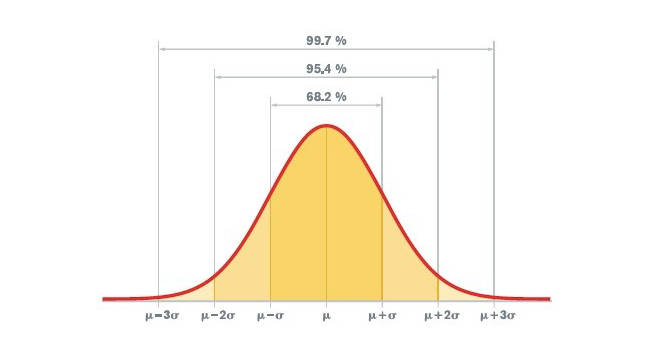

Statistical process control
Statistical process control (SPC) is a statistical technique that can be applied to condition monitoring and alarm limits. Zabawski notes that SPC evaluates the distribution of a data set (e.g., the bell curve, where most data points are close to the mean of the whole group). Following ASTM D7720 guidelines, Zabawski says, “The model is based on plus-or-minus three sigma or standard deviations—68.27% of the data set falls into the first sigma, 95.45% within the second and 99.73% within the third.” Following these guidelines, the first warning limit would be set at the value of the second sigma, with the upper control limit set at the value of the third sigma.
While SPC can work well when one sample is taken per drain interval with results about the same value, Zabawski says that when multiple samples are taken throughout the drain interval, the calculation is less useful.

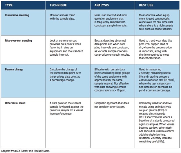

Strategies for trending data analysis
ASTM D7669 provides different strategies for trending data, including cumulative trending, rise-over-run trending, percent change and difference (delta) trending. Table 1 summarizes the four different types of trend analysis and their best uses.
Zabawski states, “Deviations from the normal trend have a far better chance of identifying faults at their earliest stages than any static limit.” According to Zabawski, the most important thing to ensure the success of an oil analysis program is to establish “what is normal” and then observe when it is not “normal.” This means that the program hinges on proper sampling, which is “pulling from a representative, consistent sample point using a proper, consistent procedure at a consistent interval.” This approach will provide the best available data to establish “normal.” Zabawski says, “Consistency is the key, because inconsistencies add noise to the data and make it harder to interpret.”
Eckert notes the saying: “The trend is your friend.” He says the best data for trending hinge on “taking the sample from the same place and the right place on the equipment, as close as possible with time on oil (e.g., every 250 hours oil time), to provide the best data for trending.” Eckert notes that trending data have benefits over just alarm limits as trending “will provide the operator the time to recognize an issue (e.g., wear, contamination, oil condition) before a flag will be raised with set alarm limits.”
When interpreting sampling data, Eckert says the cumulative trend, which uses a simple plot line on a graph, is likely the most common analysis method (see Table 1). This method allows the user to visually see a notable increase or decrease in the trend of a single data point or in grouped data. Eckert has found that oil analysis laboratories usually have web-based software available to graphically represent the sample data to permit trending analysis. When there is a high level of confidence in the sampling technique, Eckert finds trend data evaluation more useful in detecting potential problems than set alarm limits. However, when sampling technique confidence is low, trend data might be questionable.
Table 1. Types of data trending analyses.
Table 1. Types of data trending analyses. Courtesy: STLE
When a good representative data population is established and consistent sampling occurs, Eckert finds trend analysis can be used to determine the optimal drain interval, allowing maintenance to be scheduled at the optimal time. With historical data trends and maintenance records, an operator can use trends to identify when an excessive wear event is happening in a piece of equipment. This information also can be used to determine which equipment part is the source of the wear.
