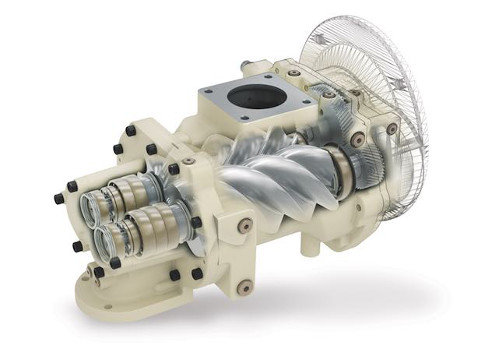

For rotary screw compressors, fluid is injected into the compression chamber to lubricate the intermeshing rotors and associated bearings. The lubricant also takes away most of the heat caused by compression and acts as a seal within the areas between the meshing rotors and rotor housing.
Most oil-injected rotary screw compressors use the air pressure in the oil sump or separator, after the discharge of the airend, to circulate oil through a cooler and a filter prior to re-injection to the compression chamber. Alternatively, some designs may use an oil pump. Bearings at the end of each rotor carry the radial and axial thrust loads, and they are lubricated directly with the same filtered oil that is injected into the compression chamber.
A similar configuration is used with built-in spiral and turn valve for capacity control. It’s critical that the lubricant be maintained on a regular basis to ensure the compressor’s moving parts, seals and bearings are well protected against heat, friction and corrosion.
