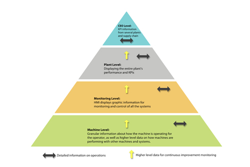

In addition to helping people better use data, advanced M2M and IoT enable devices to interact with information from another device without the need for human interaction. This type of self-organized operation minimizes the lost time and materials that can result from unexpected changes in production (Figure 1).
