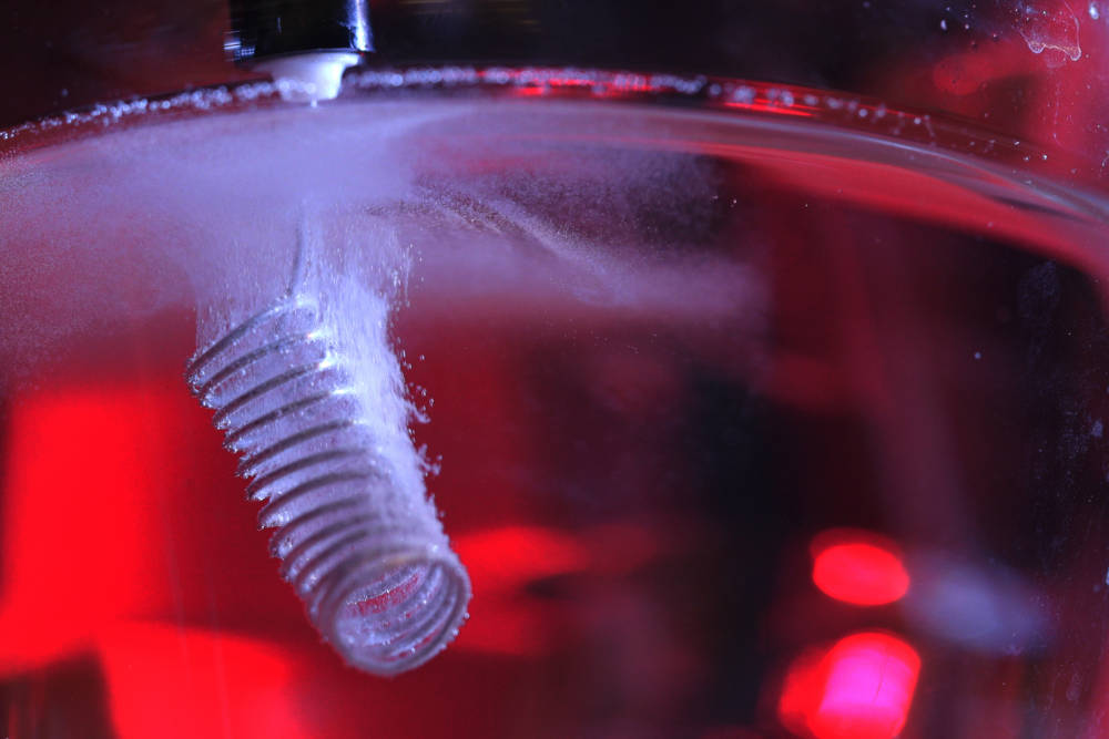

In a study appearing today in ACS Catalysis, the researchers reveal the hidden functioning of how carbon dioxide can be both captured and converted through a single electrochemical process. The process involves using an electrode to attract carbon dioxide released from a sorbent, and to convert it into a reduced, reusable form.

Researchers uncovered how carbon dioxide can be both captured and converted through a single electrochemical process in which an electrode, like the one pictured covered in bubbles, is used to attract carbon dioxide released from a sorbent and convert it into carbon neutral products. Courtesy: John Freidah/MIT MechE
