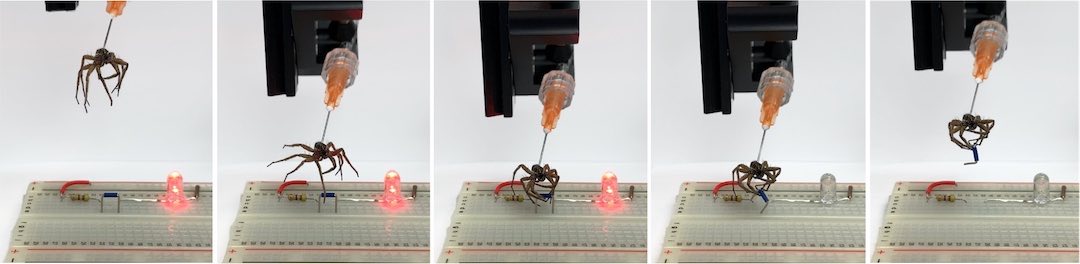

The cadavers Preston’s lab pressed into service were wolf spiders, and testing showed they were reliably able to lift more than 130% of their own body weight, and sometimes much more. They had the grippers manipulate a circuit board, move objects and even lift another spider.

A gripper is used to lift a jumper and break a circuit on an electronic breadboard, turning off an LED. Courtesy: Preston Innovation Laboratory/Rice University

Setting up a spider gripper was simple. Yap tapped into the prosoma chamber with a needle, attaching it with a dab of superglue. The other end of the needle was connected to one of the lab’s test rigs or a handheld syringe, which delivered a minute amount of air to activate the legs almost instantly.
