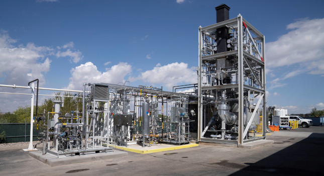

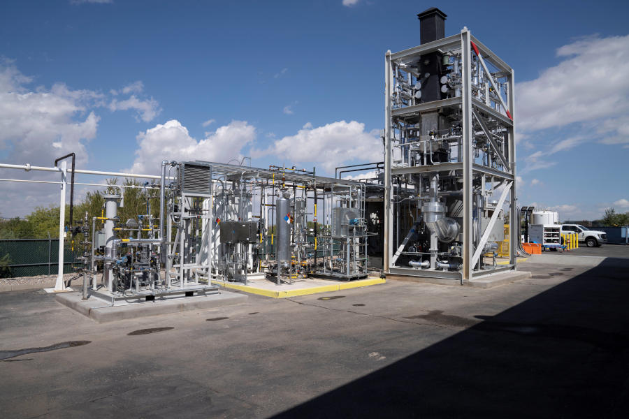

As existing equipment is upgraded, and new equipment is delivered to produce hydrogen, modern PLCs and edge controllers are providing important IIoT capabilities. Pictured is BayoTech’s hydrogen generation system in Albuquerque, New Mexico.
As existing equipment is upgraded, and new equipment is delivered to produce hydrogen, modern PLCs and edge controllers are providing important IIoT capabilities. Pictured is BayoTech’s hydrogen generation system in Albuquerque, New Mexico. Courtesy: BayoTech

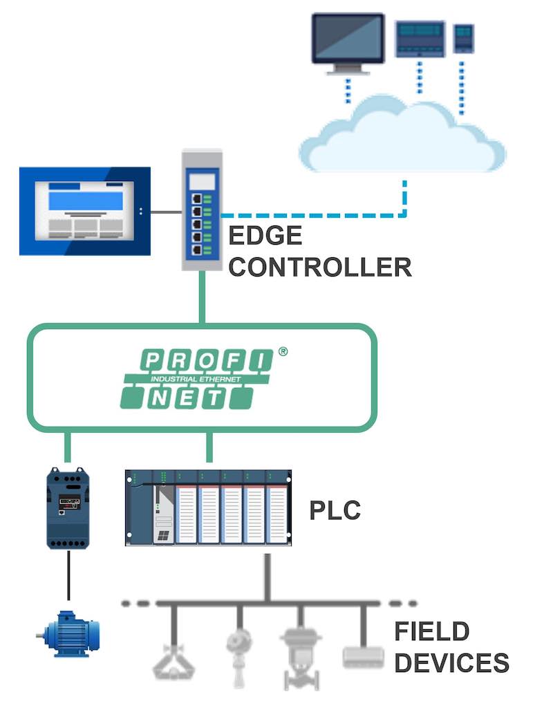

It is important to consider whether an automation partner offers a breadth of complementary elements such as safety devices, instrumentation, analyzers, and valves — especially as each of these items becomes more intelligent and readily networked with control platforms (Figure 2). Availability of asset management system, maintenance and support services ensures investment protection.
A solution provides a single point of support for digital automation infrastructure, developing automated hydrogen production equipment in the most agile manner possible and further enabling their OEM and SI vendors to execute requirements more easily.
An automation partner like Emerson can supply virtually all the hardware and software needed to automate hydrogen production systems, ensuring the best compatibility among all elements, and simplifying the design process for users. Courtesy: Emerson
