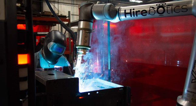

4. Process tasks (gluing, dispensing or welding) for collaborative robots
For process tasks such as gluing, dispensing or welding, the key details are the same: The robot moves a tool through a fixed path while the tool interacts with the workpiece. In each of these process tasks, it takes a significant amount of time to train a new employee to control numerous variables required to attain an excellent quality finish. If this control can instead be copied directly from one robot to another, the process becomes more straightforward.
A traditional robot welding system requires significant welding and robot programming expertise to set up and is often more expensive than a welding torch alone.
Accessories for process tasks
End-effector: A process tool such as a welding torch, sealant, glue or solder paste dispenser, is required. The tool often does not need to be designed for robotic operation, which may reduce integration costs. Turning the tool on and off is achieved using standard digital I/O signals, with the potential addition of an analog signal to control deposition rate.
Programming: Programming software process move option maintains a constant transmission control protocol (TCP) speed, meaning if the robot tool is depositing material at a constant rate, the system achieved constant coverage throughout the programmed path. The simplest method of programming a process task is defining the key waypoints within a process move along with blend radii, allowing the robot to curve around the corners in the path.
If the system is required to deal with a large number of rapidly changing parts, for which the computer-aided design (CAD) models and computer-aided modeling (CAM) process paths are available, then it may be more convenient to import these paths into the robot program rather than teaching them manually. This can be achieved with third-party software packages, outputting programs from the CAD/CAM data to be executed on the collaborative robot system.
