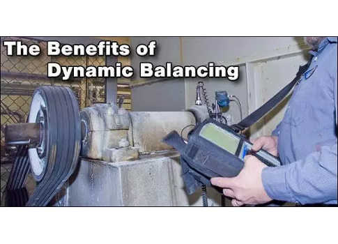

Dynamic balancing is performed with sensors attached to the bearing pedestals. It allows for the identification of the imbalance on two planes so that a real correction can take place. It makes use of machinery to identify the point of the imbalance and correct it. Other factors to consider are the length of the machine as well as its operating speed.
