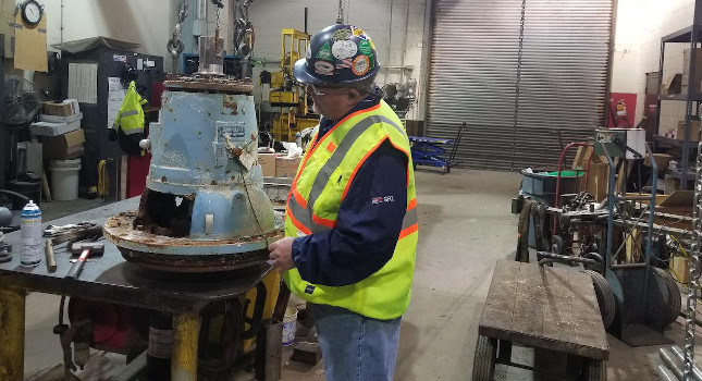

Step 3: Safety first
Safety should be the top priority during any outage. Before beginning work, all lock out/tag out (LOTO) procedures should be followed and personnel must wear all required personal protective equipment (PPE) (see Figure 1).
Because equipment is shut down, personnel may have a false sense of security. However, PPE is still required, especially for situations in which machinery or piping may retain hazardous, hot or corrosive liquids. Team leaders should review task and safety requirements with personnel participating in the work, including temporary staff onsite who may not be as familiar with this location’s LOTO and PPE rules. A zero-tolerance LOTO and PPE policy should be enforced.
