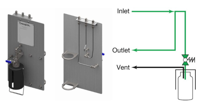

In suitable applications, first determine whether continuous flow and purging are required. Continuous flow comes in handy when the sample requires constant motion, or when a long tubing run leads up to the sample point. Under a continuous flow regimen, the sample flows through a bypass loop in the grab sampling system and avoids sitting in tubes for extended periods, ensuring the sampled fluid remains representative. The sample bottle is then filled using a spring-loaded sampling valve (shown in Figure 3). A purge assembly should be used if the sampled fluid has the potential to solidify, as it will help the dispensing needle and internal tubing stay clean.
Figure 3: This bottled grab sampling system design (3a) is used when continuous flow is required from inlet to outlet. When the operator opens the spring‐loaded sampling valve (3b), process fluid flows into the bottle, while also continuing to flow through the bypass. Courtesy: Swagelok
Fixed-volume systems are advantageous if the liquid is highly pressurized or hazardous. This type of system effectively isolates the user from process pressure while limiting the fluid volume dispensed. Here, the sample first fills a metal cylinder before being gently pushed into a sampling bottle by a low-pressure purge gas, helping to protect against inadvertent overfilling.
