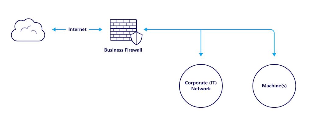

Figure 1: For smaller organizations with limited network resources, it can be tempting to plug your machine directly into the business network. Courtesy: DMC

As the need for more coordinated control and data collection grows, facility owners need more connectivity to systems. For smaller organizations with limited network resources, it can be tempting to plug your machine directly into the business network (see Figure 1).
This presents significant exposure to business and manufacturing operations. Many HMI and SCADA platforms run on some version of Microsoft Windows. This means the OT assets are now vulnerable to the same malware that could infect the business network in the case of a successful phishing attack or other infection.
On the other hand, many OT assets cannot be secured with antivirus and are often in an always-accessible mode. This means even without configuring these devices so they can talk to the internet, an operator could put a USB stick of anything on the OT network and both networks can be infected from one spot. This may sound a bit silly, but we’ve found pirated movies running on HMI computers in the past. Never underestimate the ability of a clever operator to do unauthorized things with the machines.

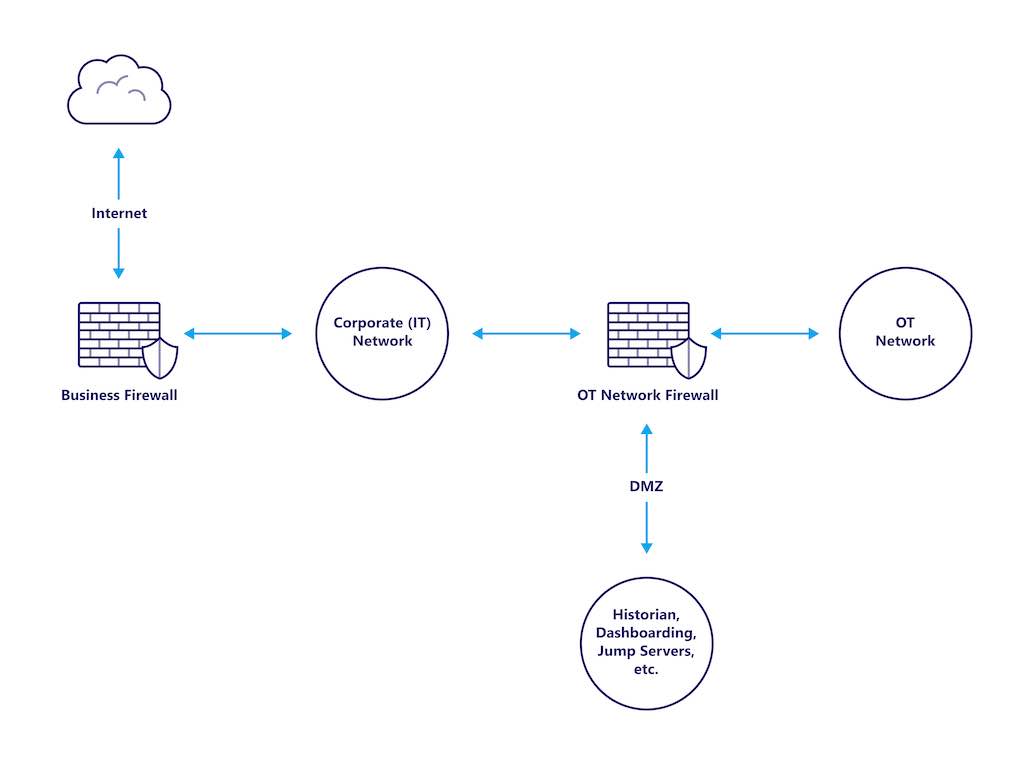

It’s impossible to remove all risk from either of these networks, but a simple architecture where IT and OT assets are separated by a firewall with needed data transfer between the two passing through a demilitarized zone (DMZ) can reduce risk. Does that machine need to be networked if you can’t implement better architectures like the simplified design in Figure 2?
Figure 2: A simple architecture where IT and OT assets are separated by a firewall with needed data transfer between the two passing through a demilitarized zone (DMZ) can reduce risk. Implement better architectures and simplified designs. Courtesy: DMC

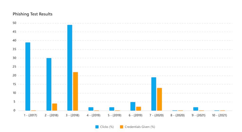

“Phishing” refers to emails designed to trick users into giving up credentials or clicking on something to install malware into the computer. These emails are getting very sophisticated. Up to and including individually targeted emails (spear phishing) that are almost indistinguishable from legitimate messages. Your first thought is probably, “My people are smart; they won’t fall for this kind of thing.” Even smart companies will have their ups and downs, though. See our phishing test history in Figure 3.
We’ve improved since those early tests, but it only takes one person handing over credentials to compromise your network. Train employees to recognize this kind of activity, teach them how to report it and notify the rest of the team and conduct security tests to ensure the lessons are learned and stay learned over time.
Figure 3: Phishing test history at DMC. Courtesy: DMC
