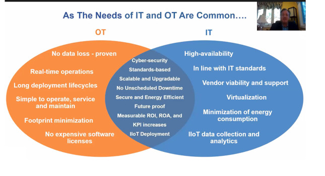

Mary DeAlba, global industrial network solutions design manager, SKF Group, said the SKF digital transformation journey began in 2017 with more than 40 participants defining operational technology and information technology (IT) requirements of a digitalized SKF smart factory standard.
Operational technology (OT) needs included industrial network hardware that could survive the manufacturing environment, support machine protocols, protects end-of-life operating systems and allow remote access mindful of the need for audit reporting and safety consideration.
IT needs included remote access with two-factor authentication, secure, encrypted with certificates, along with malware detection, resiliency and auditing, among other needs.
Lessons learned, DeAlba said, is that if IT isn’t flexible about OT requirements, OT will do its own thing. Not all OT experts want to be network experts. Demarcation of industrial IT architecture and enterprise IT architecture must be clearly defined. Clearly define support overlap; suppliers should agree. A manufacturing IT organization may be needed to bridge the gap and accommodate digitalization demands.
