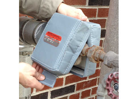

Insulating Lines and Traps
Another important aspect of improving the condensate return system is insulating pipes and traps. High quality insulation should be used, and insulation on traps should be the type that can be removed for inspection or service. A trap monitoring system can still be used on insulated traps. According to Armstrong, only a small area on the trap is needed to attach the sensor, and this can be surrounded by insulation.
