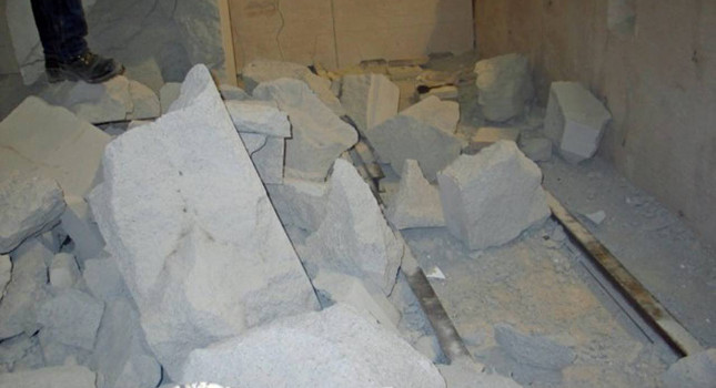

During initial dry out, the powerful effects of superheated steam can cause explosive, devastating consequences to freshly cured refractory material. Removing moisture from castables and precast shapes is a critical part of the installation. Pressures on the production department to minimize downtime can lead to rushed dry-out procedures. Usually, these ill-advised shortcuts have the opposite effect and quickly compound delays by causing thermal damage to refractory linings, sometimes leading to injuries.
Dry outs fail due to imprecise management of water extraction from refractory linings. At the boiling point of water, the pressure of steam is less than 1 psi. However, at 700 F, saturated steam reaches 3,000 psi, and possesses enough energy to destroy the most resilient refractories (see Figure 1). Too much heat, rapid ramp ups, vapor lock, poor curing and surplus water can contribute to potentially hazardous situations. Here are 12 preventive factors to manage for dry-out safety and success:

10. Cure time is critical. Every dry out is a battle between the steam pressure produced within the lining and the strength of the lining to resist that pressure. If the pressure within the lining exceeds the strength of the lining, an explosive spall will result. Recommended dry-out schedules assume a 24-hour equivalent curing time at room temperature. If cure time is reduced, expect strength to be reduced, and explosive spalling to become more likely.
