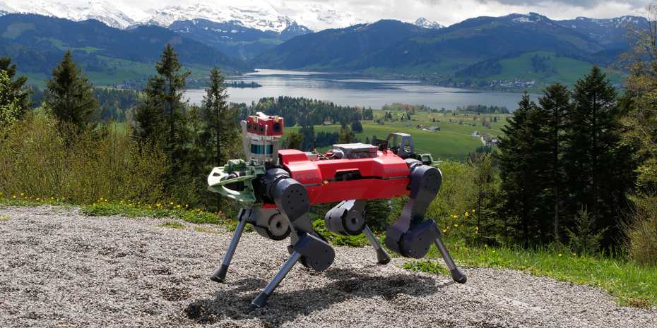

The legged robot ANYmal on the rocky path to the summit of Mount Etzel, which stands 1,098 meters above sea level. Courtesy: Takahiro Miki, ETH Zurich
