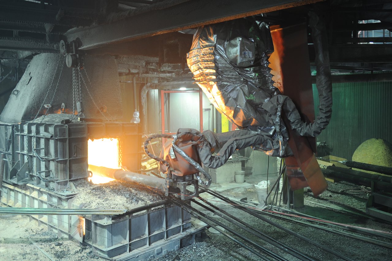

Robotic furnace tapping
Furnace tapping is a grueling job. The heavy lifting is repetitive and physically demanding. Temperatures are hot enough to melt metal. Noxious fumes and toxic dust make the task dangerous for humans. But for robots, and an experienced automation integrator, furnace tapping is no sweat.
Specialized Analysis Engineering, Inc. (SAE) is an engineering services firm with expertise in industrial automation, robotics, process controls, systems integration, fabrication and wiring. The Logan, Utah-based firm has completed projects across a wide spectrum of industries including arc furnace tapping automation for phosphorus reduction furnaces and steel smelting furnaces.
SAE has automated six furnace tapping cells for a phosphate refining facility owned by Bayer. The facility operates multiple electric arc furnaces to produce elemental phosphorus for herbicides.
During the refining process, a waste product is created in the form of molten slag that approaches 1650°C, hot enough to melt steel. This molten slag must be periodically removed from the furnace in a process called tapping. During the tapping process, the environment around the arc furnace is extremely harsh. Extreme high temperatures, the potential for splashing molten material, and noxious fumes and vapors make it hazardous for humans.
The operating environment is so extreme that even the robot needs protection. Under the metallic cover is a heavy payload robot inverted on a custom-built 7th axis positioner with coordinated motion. Inverted mounting allowed room for other activities in the workspace that would have been prohibited by a floor-mounted configuration.
Takes the heat, lightens the load
The robot must be able to operate in ambient temperatures that vary from -29°C during Idaho winters to over 38°C in the summer. To handle high ambient temperatures and the extreme process environment, the robot is protected by a heat-resistant armor made by Roboworld. SAE engineers worked with Roboworld to have their robot armor customized to accommodate the inverted mounting position and the accessory equipment required by this application.
Tool changers and an automated tool rack allow an invert-mounted robot to perform multiple furnace tapping tasks without operator intervention. Courtesy: Specialized Analysis Engineering, Inc./Robotic Industries Association[/caption]
Prior to automation, this furnace tapping process was entirely manual. It required operators to have a certain level of strength and stamina to perform repetitive tasks with heavy and cumbersome tools. By integrating a robotic system, it creates job opportunities for people who would otherwise be physically incapable of performing the previously manual tasks. The robot is also able to manipulate tools that are much heavier, more robust, and have a longer lifespan than the previous manual tools used by human operators to perform the same work.
Each of the six robotic system installations were unique to each location within the phosphate refining facility, requiring SAE engineers to design extensive structural modifications to the building and the robust mounting structures required to support these 680-kg robots. The first robot was installed in February 2013. Additional systems were installed over the next few years, with the most recent, sixth robotic installation completed in October 2018.
