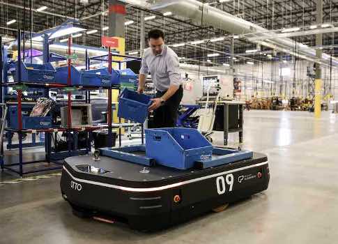

“The major driver for our customers is labor shortage. We have a number of customers who find it extremely difficult to hire and retain enough people to run their facility and support their growth,” says Simon Drexler, Director of Industrial Solutions at Otto Motors in Kitchener, Ontario, Canada.
Otto Motors is the industrial division of Clearpath Robotics Inc. While Clearpath is best known for its unmanned vehicles for researchers, including the award-winning Husky, Grizzly, and Kingfisher robots, the Otto Motors division focuses on self-driving vehicles for the manufacturing and warehouse space.
Sometimes called self-driving vehicles, all of the robots in this space share some common characteristics even though their form factors and payload capacities vary greatly. Self-driving vehicles or autonomous mobile robots (AMRs) are often distinguished from automated guided vehicles (AGVs).
Traditional AGVs typically require some type of existing infrastructure or facility modifications, whether they are magnetic strips or navigational beacons embedded in the floor, to guide the vehicles on a designated path. They work well in predictable environments.
“If you’re always moving materials directly from point A to point B and those points never change, and the path between those points never changes, then an AGV is a good platform,” Drexler said. “But that type of environment applies to a very small percentage of the material transport market.”
By contrast, self-driving vehicles (SDVs) or AMRs navigate like GPS in your car. The SDV navigates according to maps in its robotic brain, and by using various sensors, it avoids and steers around unexpected obstacles. It autonomously determines the best route or path to get from point A to point B with real-time intelligence.
“One of the challenges that our clients have expressed with traditional AGV technology is that each time a change is required in their facility, and therefore their AGV system, it’s a painful process,” Drexler said. “You have to change the track and then you have to change the programs. Usually it’s a week before the AGV system is up and running again. With SDV technology and the intelligence that’s built into these vehicles, you can literally make a change with a click of a button. You can reduce one week’s worth of effort into 10 minutes.”
SDVs allow for changes and flexibility in building layouts, new machinery installations, and facility additions.
“Self-driving vehicles enable new applications to be automated because of the level of flexibility they offer within industrial environments,” Drexler said. “By not requiring any infrastructure to navigate, the solution is able to grow and change with your organization.”
